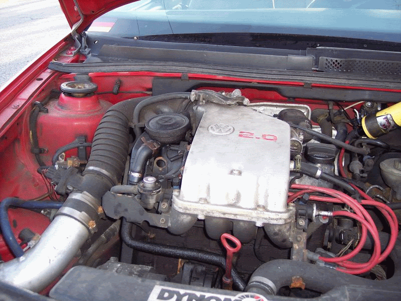

This part is broken from the bottom. I have no clue what the hell it is called. Chances are I have heard the name of it but have never connected it with this part. Anyone know what the hell it is called so I can replace it? lol XD
well I tried to get the image but it wasn't working. The part is a round black plastic piece. Looks to be attached to a coolent pipe and the air intake. Stist right on top of the engine. Top left looking at it.

My jetta is a 1990, & is different on the top - but one way to get an image that folks can examine is to post a picture on a site like www.photobucket.com or www.flickr.com, and include the link in your text. Like this:
http://i115.photobucket.com/albums/n307/Myzery97/JettaEngineIntake.gif
Copy the link and put it into the url of your internet browser to see the pix.
I got that pix by doing a google search for 'images' using the 3 words
"+1994 +jetta +engine". I hope whoever is the owner doesnt mind.
If you are talking about the circular black item that is lying horizontally atop the cam-cover, to the left of the inlet air casting, and having a fat hose connecting it to the tube running down the front of the engine.....I dont know what it is called either, but I think it has to do with the PCV system. I would look for one in the junkyards, since I doubt its a part that wears out enough to be stocked at auto parts places.
And you can print out the photo and take it along to show what you want.

Well you seemed to have described what the part is rather well, lol.
http://s247.photobucket.com/albums/gg159/Blankettool/?action=view¤t=wings20west20jetta20engine.jpg
High One
08-29-2008, 08:38 PM
w00t, you are 1337!!!!! What you said led me to this: http://www.car-stuff.com/exclusives/vw/golf-crankcase_vent_valve.html That os the part!!!!!!!! :iceslolan :iceslolan :rofl: :iceslolan :iceslolan
