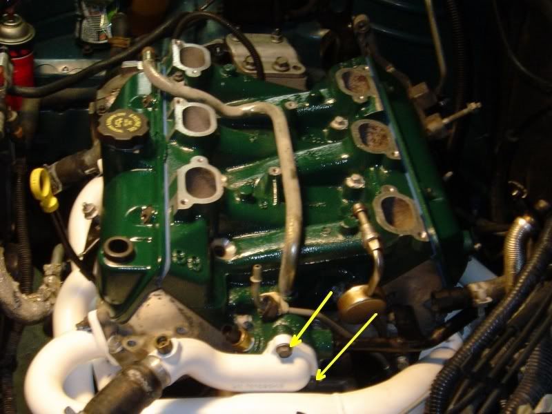

- Using a short 13mm remove the upper thermostat housing bolt. Then loosen the lower bolt, you may be able to remove the housing without removing the lower bolt all the way as the housings lower bolt hole is open.
If not, then carefully remove the lower bolt, and try not droping it into the trans/subframe/abyss area.
http://i28.photobucket.com/albums/c242/xeroinfinity/11X17RW24/34thermostat_housing.jpg
(items removed for clearity)
- You may need to work the housing around to get it, sometimes the thermostat hangs up in the intake.
