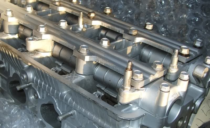

Whats wrong with this picture?
BeZerK2112
08-27-2008, 10:41 PM
My buddy got his new head for his car today. He showed it to me not knowing what to do with it. It's re-manufactured.
http://i102.photobucket.com/albums/m112/sypher2112/WTF.jpg
stieh2000
08-28-2008, 10:34 AM
Your missing something, dont know what to call it, but it gets screwed in 1.5" down and 1" in from the top left corner.
BeZerK2112
08-28-2008, 10:47 AM
No... It's got all its parts.
fredjacksonsan
08-28-2008, 11:21 AM
Uh, you have to remove the bubble wrap prior to installation? :biggrin:
But it looks like one of the cams is still in it.
Greenblurr93
08-28-2008, 11:30 AM
the cam plates are wrong... or not in the right order.
BeZerK2112
08-28-2008, 11:57 AM
Meh... you guys are getting so close! I'll just tell you. The company that remanufactured this setup actually painted the head. However they didn't paint the parts individually. The bolted it all back together and just sprayed. The cams are even painted. Now my buddy has to stip the paint of a bunch of parts so it will work properly and wont leave paint chips all over the place and gum up the motor!
Greenblurr93
08-28-2008, 12:37 PM
the cam plates are still in the wrong order...
Toksin
08-28-2008, 02:36 PM
Send it back and demand a refund.

Hungrycat7
08-28-2008, 08:19 PM
Don't waste your time stripping that paint! Send it back and demand what you paid for!
danielsatur
08-28-2008, 08:42 PM
I guess the bubble wrap will protect from further damage,he didn't want to scratch that nice paint Job.
He probably got it from LKQ ,and cleaned + Painted it befor putting it on
Craigslist or Ebay.

Shortbus
08-28-2008, 10:46 PM
He got ripped. They painted the cam lobes lol
VR43000GT
08-29-2008, 02:56 AM
Wow, how little do you have to know about cars to paint the camshafts? That is unreal stupidity and if whoever did this considers themself a business, they deserve to go broke.
