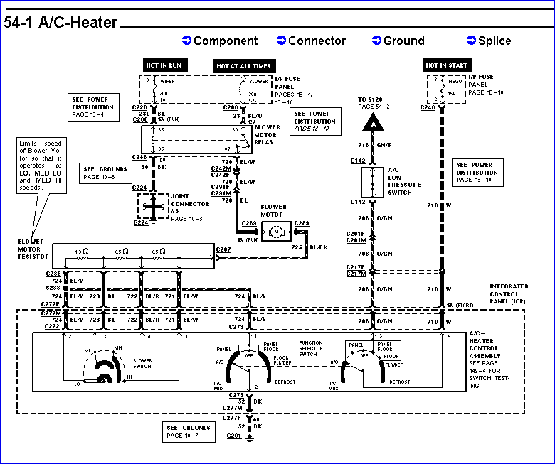

Below is the wiring diagram for the '97 blower motor. At the top of the diagram, a 30A circuit breaker feeds 12V to the Blower Motor Relay, and then to the positive terminal of the motor - a bad connection anywhere along that path could cause your problem.
The motor negative terminal then connects to the resistor pack at connector C287, and the outputs from the resistor pack plug into the Integrated Control Panel, which then plugs into the A/C Heater Control Assembly, which contains the blower speed switch. Finally, at the bottom of the diagram is the ground connection. The resistor pack will not be causing the problem, but a bad connection anywhere along that path could cause it.
There are several ways to pinpoint the problem. You could run a temporary 12V feed to the motor positive terminal and if that brings the speed back to normal then you would know that you have a problem at or above the motor positive terminal.
Or you could run a temporary lead from the motor negative terminal to a good ground point - that would cause the motor to run at full speed regardless of speed selector switch setting, and if it then runs at full speed then you know the problem would be at or below the motor negative terminal - between there and ground.
You could also find it by voltage measurements - with the speed selector switch set to 'Hi', all points between motor negative terminal and ground should read very close to 0V - if you get a reading higher than that, then it tells you that you have excessive resistance in circuit, probably caused by a bad connection.
Similarly, all points from the motor positive terminal upwards to the circuit breaker should read close to battery voltage, and anything less would indicate excessive resistance, probably caused by a bad connection or bad contacts within the circuit breaker or relay - further voltage measurements would allow you to pinpoint it precisely.
It's a simple enough circuit but there are a lot of potential failure points because there are so many connectors along the path, any of which could corrode, overheat, and fail, plus of course physical access is restricted and awkward.

'97 Heater Blower Motor wiring diagram (http://i180.photobucket.com/albums/x64/Selectron/Escort/97-ac-heater.png)
