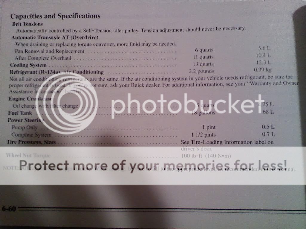

I change my oil today and I have to add to the debate of how much oil the 3800 takes. A lot people and sources say 4.5qt. I say 5qt and my owners manual says the same thing. When I changed my oil I put 1 gallon (qt) of oil in first turned the car on to get the oil circulating and then a turned it off and let it sit for a while. Went and read the oil dipstick and it was under the add mark. So I added qt of oil and it filled it up all the way but not past the cross hatches. Maybe the changed some things. I do have one of the few 3800's that burns oil though.

5 Qts. and my level is dead on the full mark.

What debate? As always, fill it until the dipstick is satisfied.

What debate?
:werd:
I don't care what GM car it is with the L36 or L67 SII 3800 engines but 5 quarts is too much and it is over the max mark/lines on the dipstick meaning it is overfilled. Sounds like someone may need glasses. :shakehead
The most important part if there is any debate is the oil filter. I no longer recommend or will use AC Delco PF47 oil filters. Poorly designed anti-drainback valves. Now made by Champion for Delco based on the crappy Ecore design. Stick with Mobil 1 or WIX brands. Mobil 1 oil filters are made by Champion too but based on a performance design.
BTW - Does this PA have the VIN "L" or VIN "K" 3800 engine?

I use and have always used 5 Quarts, at the same time I use the PF52 Equivalent Filter which is a hair longer than the PF47... So 5 quarts is what I fill with on all of my 3800's due to the filter size..
With most all 3800's over the last 20+ years you will be most likely to use 4.5 Quarts... Fill it to the top of the cross hatch as stated...
