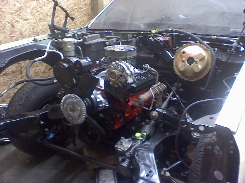

I need to replace my alternator in my '87. The block and serpentine setup in this thing I was told was out of a '93 Suburban. I ordered a new alternator from Summit and it's a different size than my alternator I'm replacing. So the problem is it won't fit in the bracket. I want this larger case size alternator because I want a higher amperage and the small case one's I've seen are about double the price of the larger case ones. Maybe I should be asking in the Suburban thread I'm not sure, but I think what I need to get is a new bracket (alternator/power steering pump bracket) that is for the larger case alternator. Anybody have input on this?

Correct, you'd have to get a different bracket if you wanted to go with an altenator that is physically larger.

The bracket for the small case will use 2 alternator attachment bolts that are 120 degrees apart, a third of a circle while the large case has two bolts that are 180 degrees or a half circle.

Thanks Silicon, I see that on the new alternator I've got, just a matter of finding out what year's and what vehicle's had what I need. Do you know when everything switched over to serpentine?

A bracket from an '89-'93 9C1 type car should work.

If no luck there, you should, if I'm not mistaken, find the larger altenator bracket on a 1990 - 1994 full size, heavy duty Chevy/GMC pickup. I got my serpentine belt assembly from a 1992 Chevy Silverado 2500 w/AC & w/o A.I.R. I just looked at it, and it appears to have the larger altenator. Lol, I got the whole belt assy over the winter and I still have yet to install it onto the Caprice.

I pulled the bracket out of this '92 (not 100% sure) Caprice today. It's definately the large size alternator bracket but when I got it home and sized my Summit alternator up to it it was about a half inch too big. I think the problem is I got the wrong alternator from Summit. I'm gunna call them tomorrow and try to get the right thing on the way. Hopefully this bracket will bolt up to my motor, I'm crossing my fingers since it seems "it's always something". I also grabbed the waterneck and upper radiator hose and the extra long power steering hardlines (must be for cooling purposes?).
