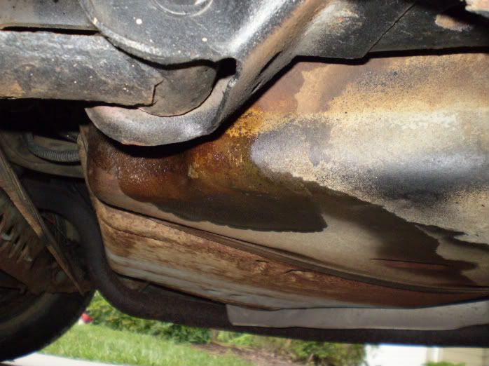

The lines are rusted. I was going to replace the filter and noticed some one had tried before and kinked the line a little bit but it doesn't seem to be leaking there, I'll replace it all any ways but I had to pull it out of the garage to day because the fumes where getting bad, backed it out into the drive where it is at an incline and it started dripping pretty good looks like the tank is busted what do you think.

It's hard to tell, usually if the tank leaks it will be along the seams. If I were you, I'd poke the rusty spots pretty hard with a screwdriver once you get the tank out. If it's solid, just leave it, I've seen lots of tanks that look worse than that that didn't leak.
