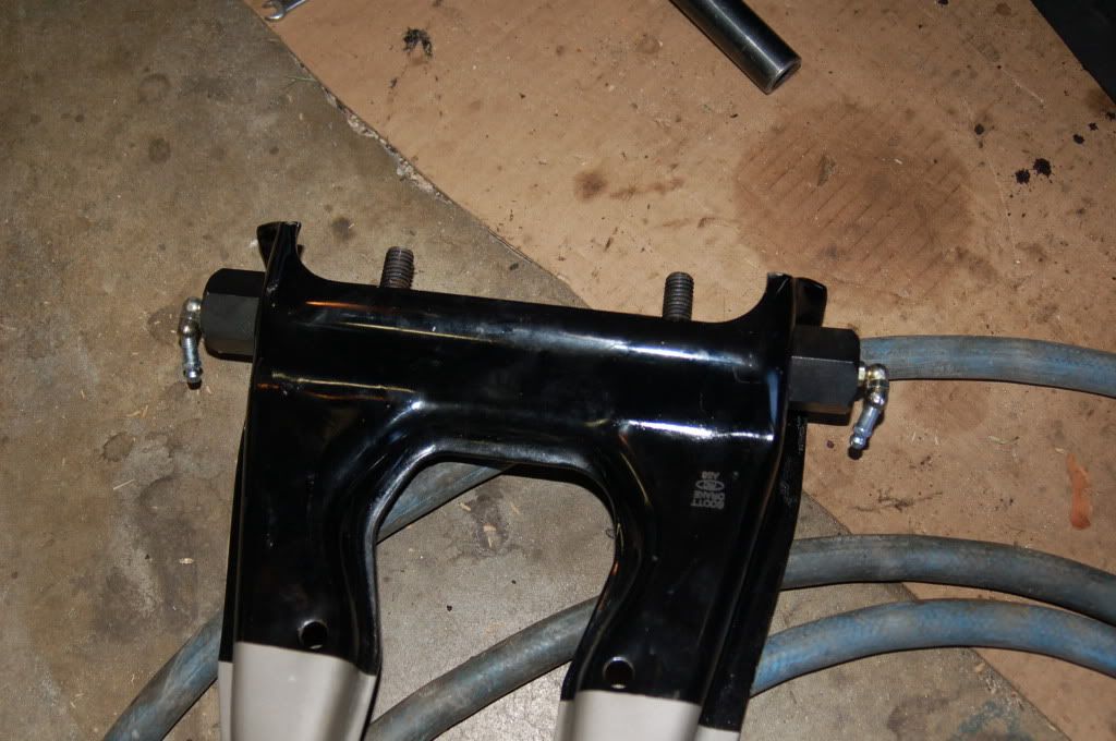

Your welcome. I also had to make an adjustment to the zerks. Ordered repro upper and lower control arms. The upper control arms end up being about 1/4" wider than the originals (not sure why). They fit fine in the shock tower but there is a problem with the grease fittings. Since you are losing that room, there is basically no way you could get a grease gun on the fittings. So, here is the solution we came up with (there are fittings you can buy from Mustangs Unlimited that also correct the problem but they cost $40, this fix cost about $5 IIRC).
It annoyed me that you couldn't get something for this locally. The guy at the local Checker Auto said "You could either drill holes in the sides of the strut tower for access, or I have seen guys take a ball peen hammer and expand the space where the zerks are." Well, neither option worked for me..
Anyhow, to the point. I found your basic 90 degree zerk (1/8") fitting http://www.huyett.com/catalog/images//GreaseFittings/Huyett/Monel/H1613M%28t%29.gif
and a 45 degree zerk (1/8") fitting http://www.huyett.com/catalog/images//GreaseFittings/Huyett/Monel/H1612M%28t%29.gif and was determined to find out if the zerk itself could come out of the fitting... I found that if I used a pair of vice grips and an 8mm (yes, I actually used metric [eew]) socket to unscrew the zerk nipple. then, incidently the next fitting screwed right in the hole of the zerk nipple. Lastly, I picked up the http://www.huyett.com/catalog/images//GreaseFittings/Huyett/1-8_NPTMaleThread/H1669%28t%29.gif long nipple and put that into the 45 degree.http://www.huyett.com/catalog/product_info.php?cPath=24_134_83&products_id=467 The key I found was that 8mm socket to unscrew the nipples, I had tried other items and quite a few standard sizes to no avial.
Here is what the finished product looks like:
http://i287.photobucket.com/albums/l...s/DSC_6295.jpg (http://i287.photobucket.com/albums/ll130/msrae_generalchaos/DSC_6295.jpg)
http://i287.photobucket.com/albums/l...s/DSC_6298.jpg (http://i287.photobucket.com/albums/ll130/msrae_generalchaos/DSC_6298.jpg)
http://i287.photobucket.com/albums/l.../DSC_6301a.jpg (http://i287.photobucket.com/albums/ll130/msrae_generalchaos/DSC_6301a.jpg)
MagicRat
08-05-2008, 09:59 AM
Nice fix. And a nice, super clean undercarriage. !! No rust/dirt/oil/grease like on my classics!!
