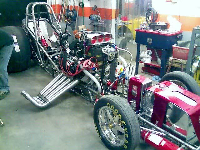

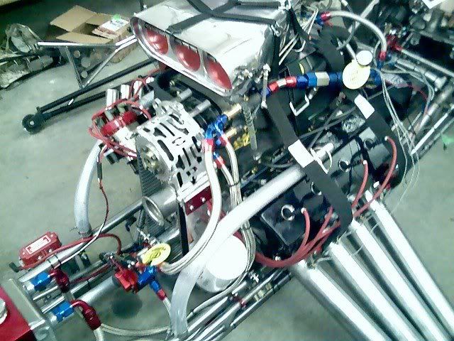

some chassis shots(sorry shitty cell phone pics)
http://i4.photobucket.com/albums/y119/92caprice/fcdone.jpg
http://i4.photobucket.com/albums/y119/92caprice/engine.jpg
http://i4.photobucket.com/albums/y119/92caprice/enigne2.jpg

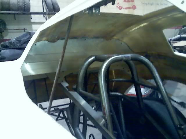

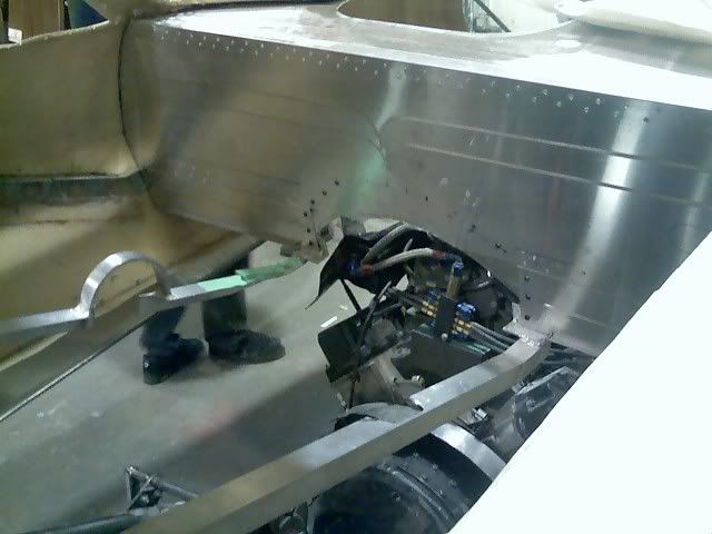

Been working alot lately to get the corvette tinned, and some bodywork, to get it ready to go for paint, some pictures of the tin, we are hoping to have it sitting at the painters Dec 1, but we will see what happens, BTW Mrpbody, is that you car that went 6.59 testing last weekend, heard about it on another forum i visit, assuming there arnt to many other alcohol pontiac funnycars out there.
Some Pics
http://i4.photobucket.com/albums/y119/92caprice/corvettereartin.jpg
http://i4.photobucket.com/albums/y119/92caprice/corvettedash.jpg
Some Pics
