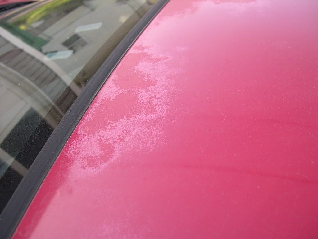

A Honda dealership certainly isn't going to fix the problem for free. You should take it to a detail shop and have them buff and wax the car. There's no guarantee that this will fix the issue, especially if it's so far gone that the clear coat has deteriorated for too long. Chances are the issue was caused by not maintaining the car's body...not waxing and buffing the car when it needed it. Leaving the car out in the sun all the time will also damage it as well. I'm not trying to say that there isn't a problem with the paint they use, but no paint is going to look new unless you take care of it. I'd also like to note that my car has the same problems as well, even after being repainted before I bought the car:
http://img.photobucket.com/albums/v473/CivicSpoon/DSCN0145.jpg

There is no clear coat left in these damaged areas.I have been around cars all my life and by no means am I a paint expert. Other than the roof and trunk the rest of the paint looks almost new without ANY fading. My daughter has washed this car religiously but I can't say it has been waxed a lot. And still most of the paint looks really good. I did notice when I first saw this car when it was for sale that this color was very unusal compared to the more popular colors preceding it. I think they are always experimenting with colors and the customer gets the brunt of bad choices by Honda. I have a 93 Honda Accord that still looks really good when I put a coat of wax on it. There is no fading at all on this car. But I don't do it that often and the paint seems to weather the elements. I will never get Honda to admit fault because obviously it will cost them money.
