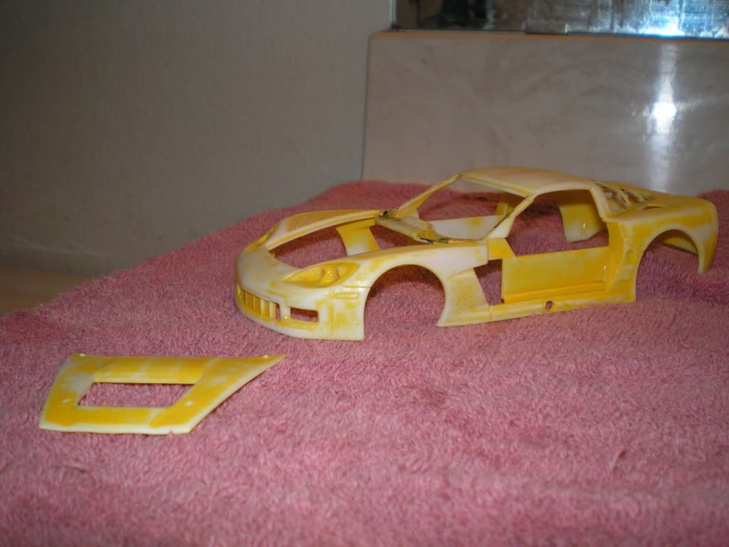

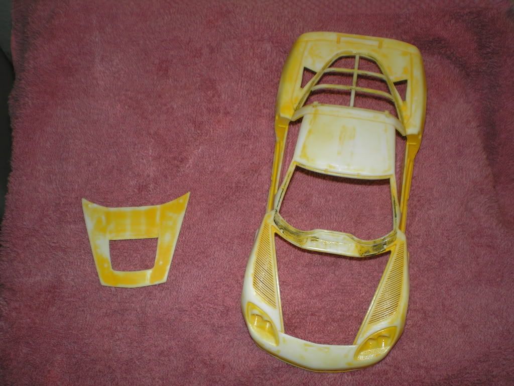

I was painting the body of a corvette im working on, and when I put on the clear coat i didnt realize the humidity in the air and it made the clear turn all hazey in spots.
Ive been soaking it in Purple Power that I got at Walmart and the paint is prettty much all gone.
My question is, do I have to remove all the paint until the entire body is white agian? There are just a few spots where the paint is paper thin and is smooth, but wont come off.

I would just sand the spots down with 1000 grit.

Sand it with a very fine grit sandpaper or soak it in isopropyl alcohol.

I use brakefluid (old type)to remove enamel paint and I use draincleaner remove to acrylic paint.

pour yourself a fresh new batch of purple stuff and put the vette back in for another day, this is how ive been stripping chrome and paint lately as well.
