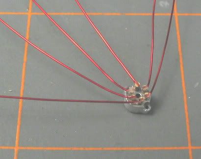

The best approach is what works best for you.
If you've already seen several tutorials, what more are you hoping to find?? Pick your favorite technique and freaking do it already. It's one of those 'techniques' that doesn't have an approved textbook approach. Which way do you think will work best? Find some pics of the engine you're building, and make your engine match the pics.
Here's my technique-
http://i211.photobucket.com/albums/bb112/andrejmiller/993-050.jpg
-but then, it may not work for everyone.
