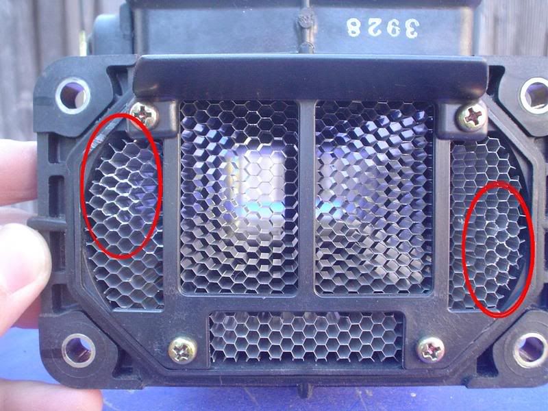

Okay, here are some pictures of what happened--honeycomb was bent at 2 spots. We tried bending them back to the original shape but I don't know if the damage has already been too great to reverse because I've heard that the honeycomb inside the MAS is very sensitive:
http://i50.photobucket.com/albums/f350/sLADe781/DSC01576.jpg

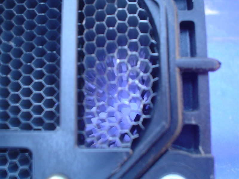

Close-ups:
http://i50.photobucket.com/albums/f350/sLADe781/DSC01577.jpg

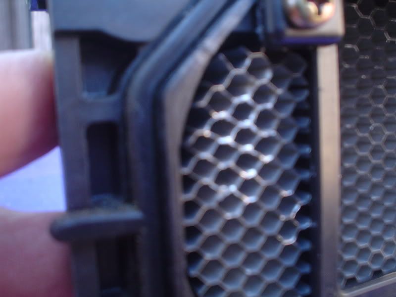

and
http://i50.photobucket.com/albums/f350/sLADe781/DSC01578.jpg
I put everything back together and the car has been on for about 10 minutes now with no CEL light on so that's good thus far. But what am I looking out for if the honeycomb/MAS needs to be replaced? CEL light? Rough idle? Car running rich (we could tell by the smell of gas in the exhaust fumes, right?) or running like crap!?! HELP!

Yes they are sensitive, but the main thing u dont wanna damage is the little sensor on the other side. dont get me rong u dont wanna mess up the honey combs obviously, but to be honest im guilty of that my self lol. mine has a nice section thats kinds smashed a lil, and i didnt even try to fix it like u did and my car has seen absolutly no difference in its idle or driving. so i havent messed with it. so i think u will be ok. like i said mine is smashed, (i should fix it but im to lazy and it hasnt affected my car so i havent messed with it) and i have no cel or anything. u will be fine just put it back together and start it up. and if the mas is bad u will know. the car will idle rough and will prob stall or u will have to keep giving in gas to keep it running. but it will be pretty obvious if there is a problem.

what i see there doesnt look bad enough to cause a problem.

Agreed, I had bends that were worse that didn't cause issues. Your MAS should be fine. You'll know as soon as you hook it back up. As for the sensor. DO NOT CLEAN IT WITH ANYTHING!!! I used MAS cleaner to clean mine and it toasted it.
