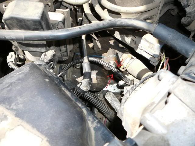

ok so there wasn't a sensor directly above the thermostat housing but i think the wire in this picture is it. it seems to be going into the heater core.
http://i73.photobucket.com/albums/i224/fuckass6771/P1060892.jpg

Sorry, my bad. I should have checked better on this as I'm so used to doing everything on the 3.8 engine. What you have found is the Coolant Temperature Sending Unit. Didn't you say it has one wire? It would be Red/White. That and your location photo confirm you have the sending unit for the temp gauge in the instrument cluster. The ECT is a two wire sensor located in front of the distributor and behind the ignition coil and the valve cover oil fill. I suspect it is screwed into the intake manifold. The wires to it are Light Green/Red and Gray/Red.
Hope this helps.
