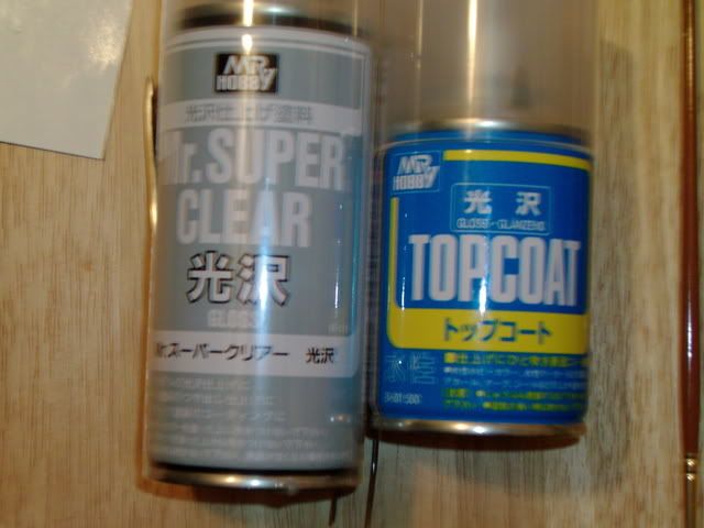

I bought a couple of cans of MrHobby's clear coat because several members on this website suggested it worked better when sprayed over decals then other brands such as Tamiya. I tried it and it worked nicely. Now this was about two years ago and since then I've added a new hobby to my life and been going back and forth between RCs and scale models. Anyway, to avoid getting off the subject, I ran out of MrHobby clear coat and went to my LHS to purchase some more, but they didnt have what I normally bought. Instead, they had the large silver can. Now I dont understand Japanese but looking at the words I noticed they look similar. My question is, is this the same thing only in a larger can? Is the silver can also friendly when sprayed over decals? I remember similar threads to this were posted up before and I remember asking a question in which someone replyed that I steer clear from the silver can and get the blue can. Is this the same except MrHobby offers their clear coat paints in two different can sizes?

Topcoat is water-soluble acrylic (like Mr. Aqueous Hobby Color and Tamiya Acrylic that come in bottles), while Mr. Super Clear is solvent-based acrylic (like the bottled Mr. Color, Mr. Color spray and Tamiya spray). The paint film of water-soluble acrylic tends to be softer, so it's a bit hard to achieve a mirror-like surface after polishing. Also, Mr. Hobby Topcoat is relatively easier on decals, but if you have to moisten already-applied decals with any type of paint, take usual precaution--always start with a few mist coat.

Hmm i been using the silver bottle since i started modelling and been shoting on wet coats from the start.... and i never screwed up a decal YET. My decals are soften with mark softer then usually i let them dry before spraying clear
Gaia colours are nice too hahaha ive got some of them
