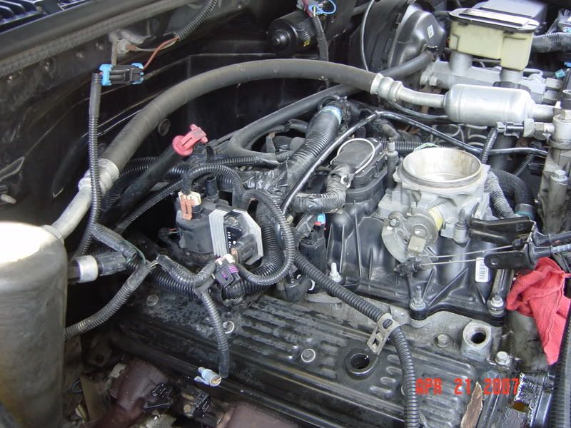

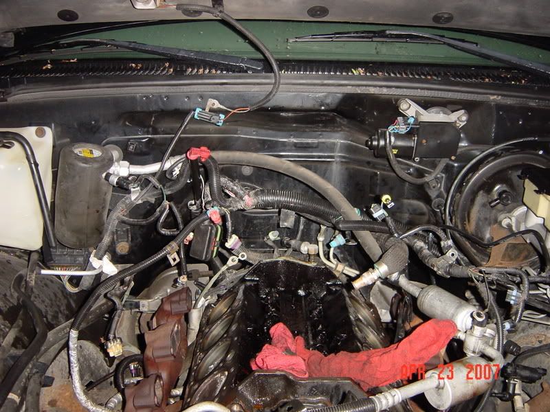

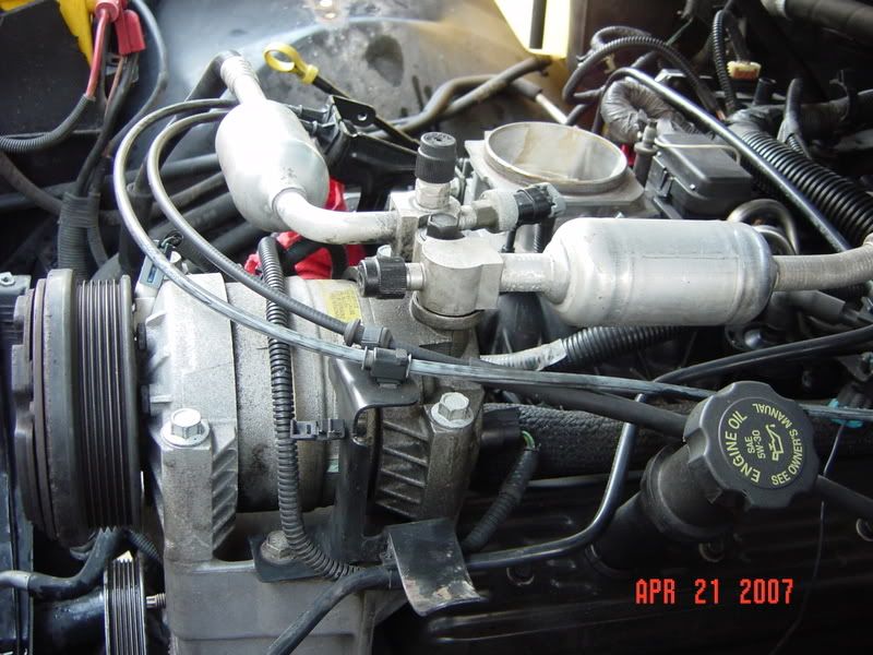

Just did mine in april of 2007. 1998 Chevy Silverado K1500. I went ahead and put head gaskets on too while I was in there. Fairly easy I thought. I did drain out the a/c but you might be able to swing it out of the way. I had to scrap off gaskets so I wanted as much room as possible. If you got a digital camera I recommend taking some pics of the wires and odd ball things you might forget.
http://i30.photobucket.com/albums/c308/shakes1977/DSC03164.jpg
http://i30.photobucket.com/albums/c308/shakes1977/DSC03168.jpg
http://i30.photobucket.com/albums/c308/shakes1977/DSC03178.jpg
This is better than writing stuff down if you ask me. That way you can remember which way hoses ran over and under what, etc. I left the upper intake attached to the lower part and pulled the whole assembly out together. Ill get the torgue specs in a second.
