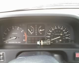

dan89
07-31-2008, 08:09 PM
Tony
07-31-2008, 08:11 PM
hahaha...automatic!!! :sly: :lol2:
dan89
07-31-2008, 08:16 PM
couldn't pass it up either way for $24 :D
