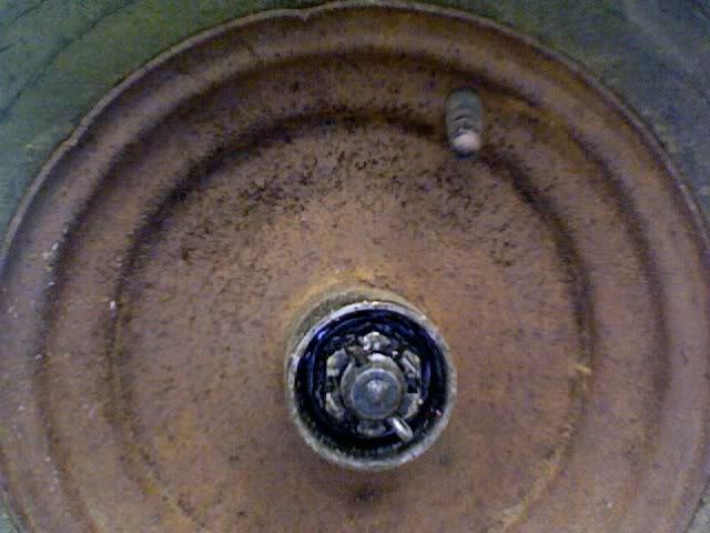

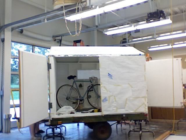

I have been building a small trailer on top of a flatbed. It is approximately 5' wide, 7' tall and 7' long. The flatbed was given to me and the tires are far from roadworthy, SO,
I need new tires.

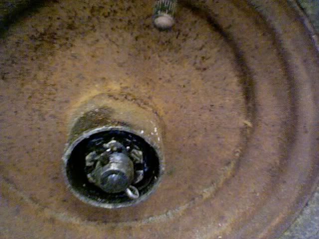

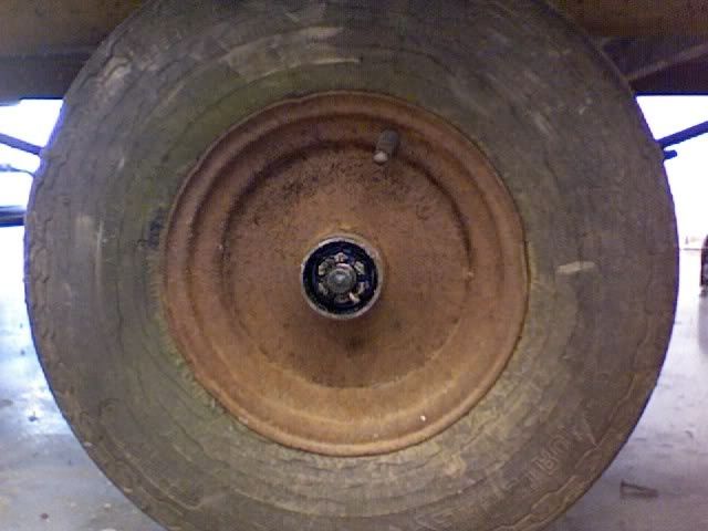

I cannot figure out how to get the old ones off, and do not know what kind of tires to purchase to replace the others now that the flatbed has a significant amount of weight on it.
Here are some pictures of the trailer and the tires. Any advice?
The tires seem to be using some sort of pin?
The part I've built on the flatbed is made of wood.

Pull out the split pin and undo the nut.
You may want a mechanic to do this, as these wheels have tapered bearings and will need to be adjusted when the wheels are put back on.

Yup, remove the cotter pin, back off the nut and the wheel should slide off. You need to pack the bearings with fresh grease and replace the oil seal on the inside of the hub. If you've lost the grease caps, this will have a negative impact on bearing life.
Also have the rims looked at, they look pretty rusty and may not be fit to mount a tire onto. But you won't know until you take the tires off. I agree with having a mechanic or someone with some knowledge give you a hand if you've never done this before.

The wheels look rusty, but only on the surface. I don't see any flaking or thick scale. I think an hour of work with a rust removing 3M scouring wheel on a drill and some paint would spiff them up decently. I'd also hammer out the rim dents. Replace the wheel bearing dust cap before you spray paint 'em. Looks good so far though!
