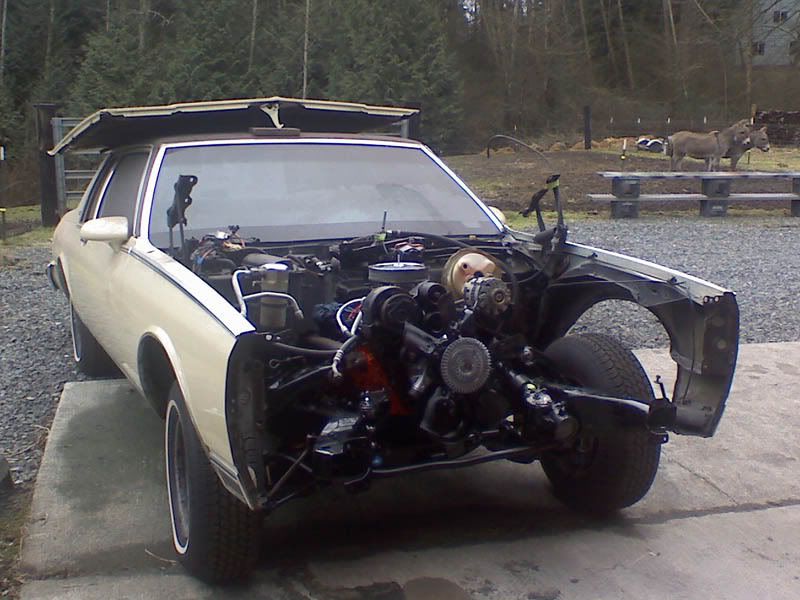

So I'm in need of a car now and I need to fix my stepdad's 1988 Caprice. I hope you guys can help me out. My mom crashed the front into a truck and it got kind of messed up. :P
Anyways, you think you guys can help me find the parts that I need to buy with these pictures? I know it's hard because they are pictures, but name the ones you see, please. :)
Thanks, Alain

Looks like new header panel and grille time. Check the radiator support behind to see if it's damaged, doesn't look like it might be though. You haven't shown the hood so I don't know if you need one of those.
At any rate, it appears from your photos to be cosmetic, superficial damage.

Looks like you just need the header panel. Not sure if the radiator support was damaged or not but if it was then you'll need that too and maybe a radiator if it's messed up. Headlights look good which is a plus because it's easier to find a header panel without headlights sometimes. People take the headlights out and sell them because new they're somewhere around $100. Any header panel from 87-90 will do just fine.
http://ebay.carpartswholesale.com/images/products_ebay_cpw/29416986.JPG
That's what I'm talking about but I recommend checking your local junkyards. You should be able to find a 87-90 Caprice no problem usually and you can get the whole peice you need. It's real easy to remove and install. Can't remember exactly but maybe 5 bolts each side for top corner of fender and a few bolts each side to the radiator support. Just unplug all the lights from up there and it's not even that heavy either.

Don't forget, the A/C condensor is in front of the radiator, and is more than likely shot. If you want A/C, that's gonna need to be replaced as well.

Ok thanks. Anything else? Also, do you see that metal thing going around the headlight on the last picture... where can I find that?
'97ventureowner
06-01-2008, 11:02 PM
Those should also be available at a salvage yard. They are called 'headlight bezels'. From the pictures in your first post it also appears you need to replace the rubber/polyurethane filler panel between the header panel and the front bumper.

All that will be attached more than likely if you find one at the junkyard.
