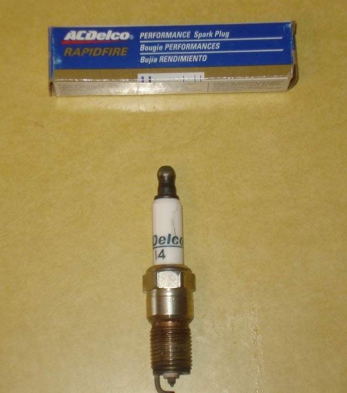

Your problem is most likely the Delco Rapidfire 14 plugs which can be used but not really a good replacement plug for the OE double platinums. I recall there was a major manufacturing defect concerning them. Here is a pic of one and you can clearly see a crack with carbon tracking. They were exchanged for other brand spark plugs and no further issues.
http://i5.photobucket.com/albums/y186/lizzywiz/acdelco_crack.jpg

I agree again Bob. The ceramic insulator failure is the reason Delco is starting to phase out Rapid-fire plugs. It's also the reason I would never use them.
