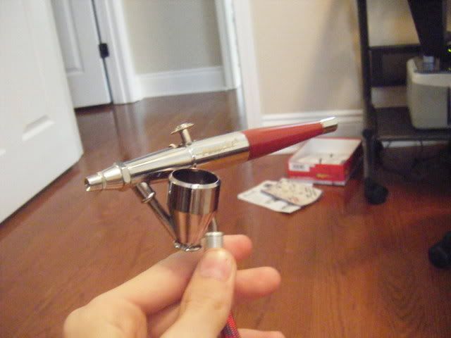

this is the air brush I got. It isn't the best airbrush, but I'm sure it will do. I bought it for $100.00

It's a perfectly good airbrush. It will do everything you need it to, and you're not likely ever to 'outgrow' it. The only thing you need now is to learn to use it.

Everything MWPR says is completely, totally, utterly right - including the points many novice painters ignore: thin the paint A LOT and use minimum pressure.
I also have an Paasche H-Series. It's just fine for painting car bodies.
