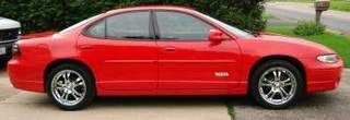

IMO the reason why you have the issue is because of the 114.3 bolt pattern of the wheels not because they really need the hub centric rings. Remember that is .7 mm off at each wheel stud compared to stock. If you had gone with 115mm X 5 you probably would not have an issue. There are too many variances in aftermarket wheels no matter what brand. I have American Racing Casino 18" inch wheels but in 115 X 5 and alternate around 100mm and I don't need the hub centric rings nor do I have any wheel shimmy or vibrations even up to above 120 mph or more. With GoodYear Eagle RSA tires in P245/45/18. See link below for better explanation of what hub centric rings really do and conditions for needing them.
Click here (http://www.justforwheels.com/index.jsp?cat=hubcentric&sub=how)
