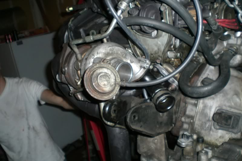

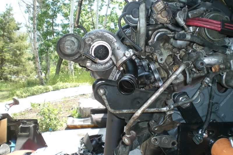

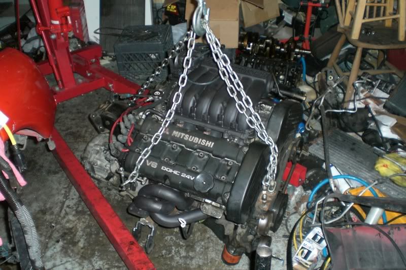

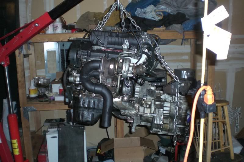

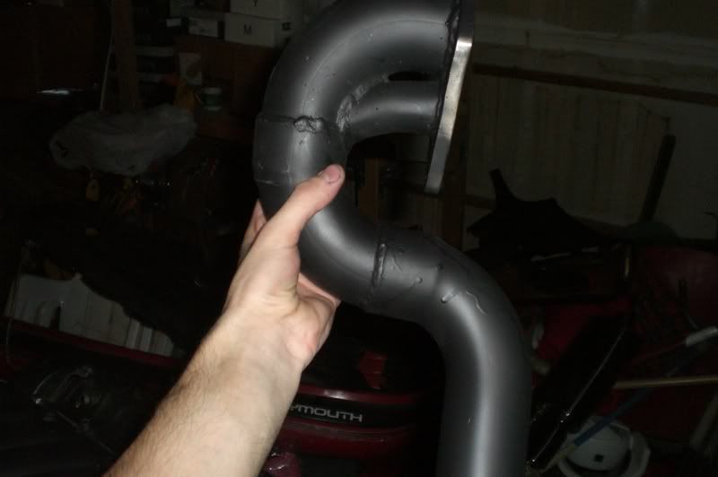

Finaly!! I got some pictures!! sorry this took so damn long!! and I was supost to finish this by friday.. but my Frickin turbo never showed up1! AAARRR
http://i39.photobucket.com/albums/e165/jason_bet/CIMG1851.jpg
http://i39.photobucket.com/albums/e165/jason_bet/CIMG1852.jpg
http://i39.photobucket.com/albums/e165/jason_bet/CIMG1853.jpg
http://i39.photobucket.com/albums/e165/jason_bet/CIMG1854.jpg
http://i39.photobucket.com/albums/e165/jason_bet/CIMG1855.jpg
http://i39.photobucket.com/albums/e165/jason_bet/CIMG1860.jpg
jason_bet
06-29-2008, 04:43 PM
http://i39.photobucket.com/albums/e165/jason_bet/CIMG1858.jpg
http://i39.photobucket.com/albums/e165/jason_bet/CIMG1857.jpg
http://i39.photobucket.com/albums/e165/jason_bet/CIMG1856.jpg
http://i39.photobucket.com/albums/e165/jason_bet/CIMG1859.jpg
http://i39.photobucket.com/albums/e165/jason_bet/CIMG1861.jpg
http://i39.photobucket.com/albums/e165/jason_bet/CIMG1862.jpg

i was drooling over them. Love the flat black (powdercoated?) plenum and manifolds. Not much to say exept...nice belt, but next time try a smaller one :P
