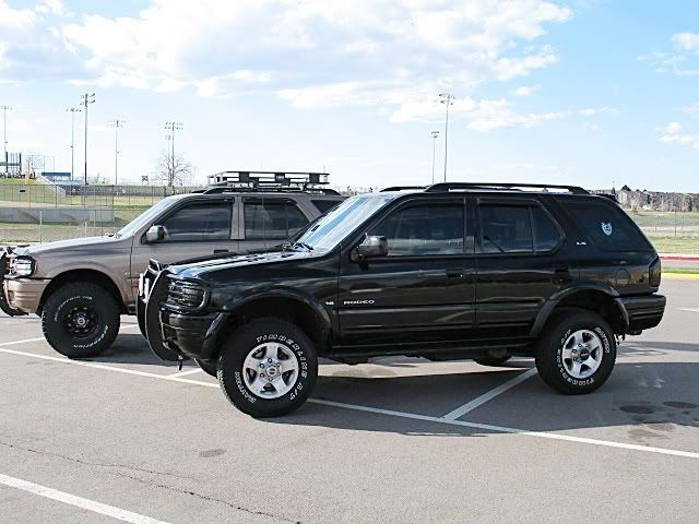

Here is mine with 32x11.50-15 bfgs and aftermarket wheels with 3.75" backspace and 3" lift..
http://i30.photobucket.com/albums/c337/Gizmo420/Rodeo%20blackout/Img_0642.jpg
http://i30.photobucket.com/albums/c337/Gizmo420/Rodeo%20blackout/Img_0643.jpg

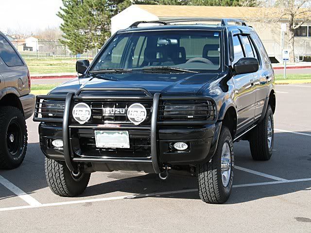

And the trimming I had to do to the front fenders and bumper..
http://img153.imageshack.us/img153/7157/img0659nv4.jpg
http://img215.imageshack.us/img215/3661/img0658cu4.jpg
http://img176.imageshack.us/img176/2268/img0661wp2.jpg

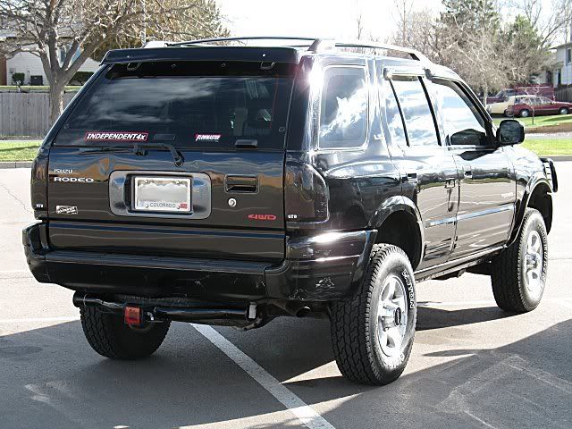

I also had to drop the rear bumpstops 2" to prevent rubbing on the edges of the tires..
http://img360.imageshack.us/img360/7751/0405081235in2.jpg
http://img100.imageshack.us/img100/5888/0405081232fz2.jpg
I still get a little rubbing in the front when I get it extremely twisted up but its just hitting the plastic inner piece. I need to trim it a bit more.
Personally I think it rides alot better with the OME springs and cranked t-bars.
