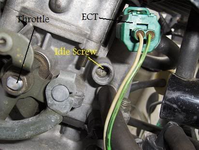

The screw is on the right side of the TB as you face the car. It is located below the yellow arrow in this picture. is is low on the TB but above the intake plenum. There should be a black cap with black tab. Pull on the tab and the cap will come of the screw located inside the TB. Use a philips screw driver and turn clockwise to reduce air into the intake thus reducing idle. If the scew goes all the way in and the idle is still high then air is getting into the compbustion camber thru a vacuum leak.

Please make sure all hoses are connected and not cracked per the underhood diagram. And then use carb cleaner or mist of water to check for vacuum leaks. More than likely you have a vacuum leak. It is also possible that your throttle cable or linkage is binding and not going all the way back when foot is off the gas pedal. TPS may also be a problem, but I rather doubt it. Once you get the idle down you will want to re-time it.

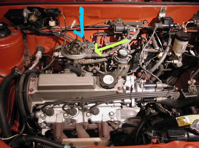

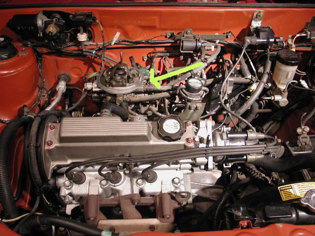

Find the ISC motor valve between the backside of the TB and the fierwall. It looks like this:

just under the blue arrow
http://img.photobucket.com/albums/v489/RossT/Image059-2-1.jpg
Notice that it has two tubes coming off it for two hoses. One hose goes to the air cleaner and one hose go to the TB. The engine creats vacuum and sucks air from the air cleaner thru the open valve and into the TB. When the valve is shut, no air should go thru. The valves go bad frequently on these cars allowing air to pass when it shouldn't.
Find the hose that goes from the vavle to TB. YOu can disconnect it at the TB or the valve and plug it with your finger.
Good Luck.

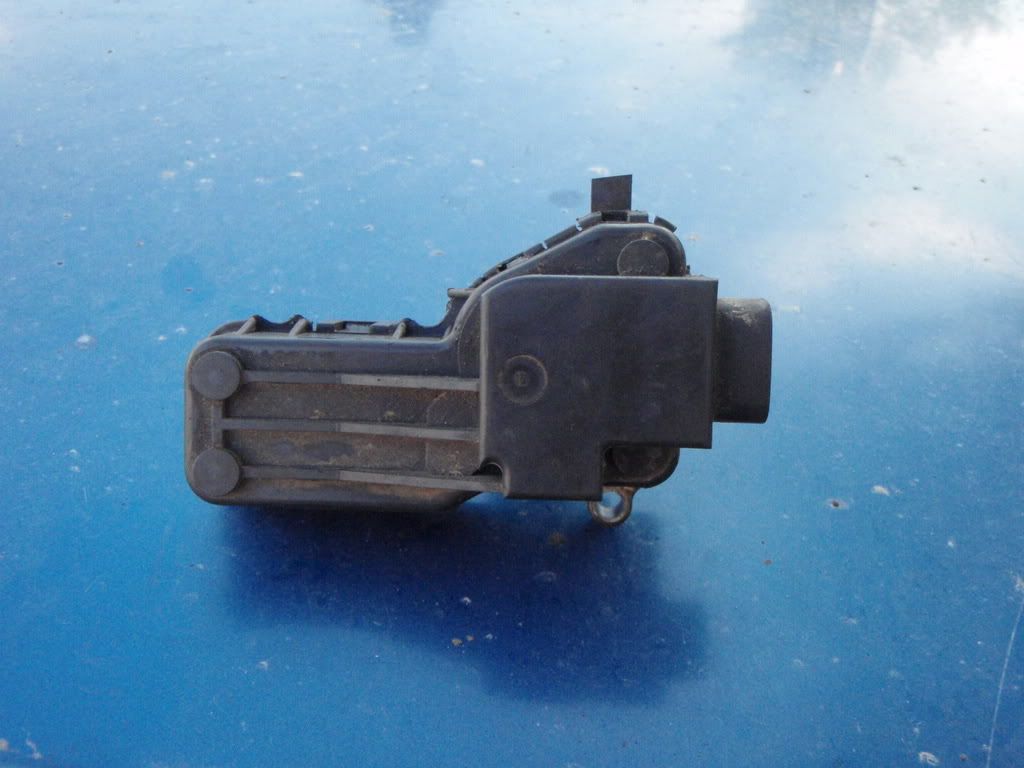

What year is that ISC valve motor? I think that I may have a different setup from what you are describing. I have the ISC motor but it doesn't look at all like the picture that you have posted.
Here's what mine looks like.
http://i303.photobucket.com/albums/nn152/burnidaho/P5030426.jpg

Yep. That's your idle control motor. Ross was refering to the earlier version. You apparently have a later model. Speaking of which, what year is your vehicle?
