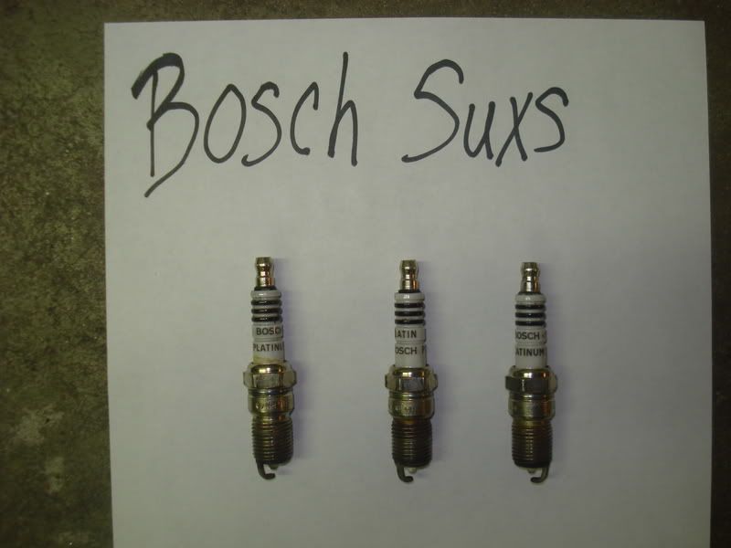

Here is a good example of why not to use Bosch plugs. Of the 6 replaced under routine maintenance these 3 Bosch single platinums were pulled out of a '00 GT (NA SII 3800) after only 4K miles. Symptoms fixed cylinder misfire DTCs P030X and a blinking SES/CEL light. As a result all 6 were replaced with AC Delcos. The pic is self explanatory and worth a thousand words.
http://i5.photobucket.com/albums/y186/lizzywiz/DSC00831.jpg

Well, I've driven 600kms so far and its running better then before....I hope I don't run into problems. :) if I do I will post for help!!

I look at the bosch plugs, The center electrode seems to be covered by the ceramic insulator. Often thought to myself..."What happenes when this tiny exposed center electrode fouls out?" Have to cut your hands all back up fighting with removing the rear spark plug boots all over again. Not worth it....
