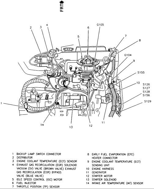

Why can't I seem to find a idle speed control motor anywhere?
flashlight
05-17-2008, 07:15 PM
The idle speed control motor looks like a black box on the back of the throttle body. I came across a brief section in the factory service manual. I hope that this will help you in your quest.

Thought I'd give you a visual on what the idle speed control motor looks like.

On the other hand I took a picture anyway:
http://i77.photobucket.com/albums/j64/isc20/iscmotor.jpg
