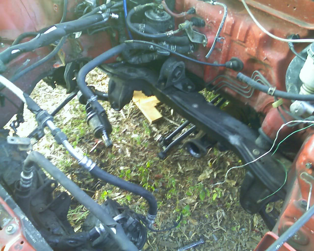

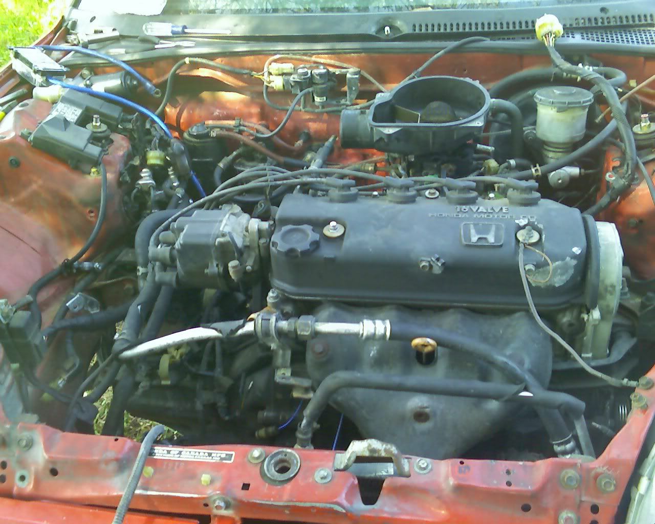

So I started at around 2pm and just before 4 I had the old baby out..its was so easy and smooth. I was completely alone for half the day.
(radiator, battery and battery tray out)
http://i48.photobucket.com/albums/f246/FrodoGT/05-13-08_1640.jpg

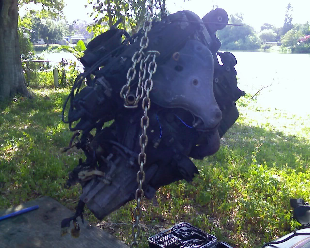

(I had to take the oldie out titanic style lol, it was at an even greater angle than this to clear the ac lines that I was NOT going to remove)

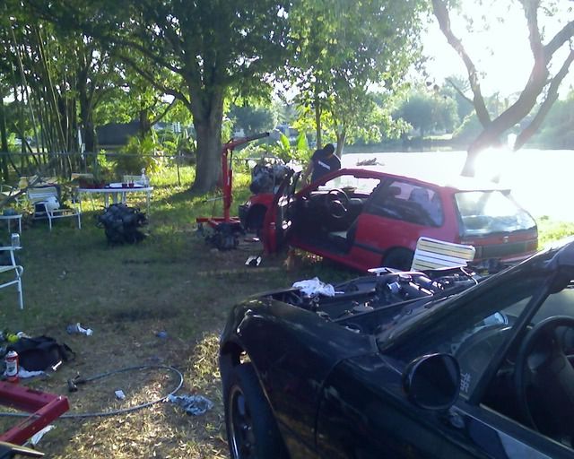

((ITS OUT! Even after the lift dug into the dirt and threatened to tip..and took 20 mins of inching with a prybar to get it away from the car. Overall there is not much at all connected to these things.)

The quickly growing engine garden. Theres My car, the new Y8 swinging tantalizingly close ot being put in. In the foreground my friends supercharged miata that just got the block dropped in after wearing the rings out on the stocker. then another miata engine decorating the landscape..with 2 more miatas and 2 626 turbo sedans behind me.
