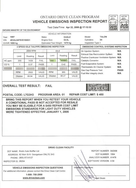

Well It was that time of the year again and I had to get my car etested. I had a distinct feeling it was going to fail but I never imagined it would fail harder than they had ever seen before... I'm so proud right now :tongue:
I'm not too worried about it but this is pretty hilarious so I had to show.
http://i83.photobucket.com/albums/j294/steviekallday/etestlol.jpg
Hydrocarbons Max allowed 200ppm
The Stevie K Mobile......... 8769ppm
Eat that environment

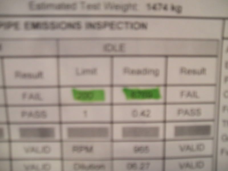

Picture upgraded
http://i83.photobucket.com/albums/j294/steviekallday/scan0001.jpg

so why is your car so far over the limit? i dont know anything about talons so i just wondered.
david-b
05-06-2008, 08:52 PM
Because of the mods that he has. He probably has stripped out everything and anything dealing with emissions. Probably not cat, no egr, cams put out more emissions, and dsmlink I'm sure helps to it. And of course the turbo is pushing more exhaust out at a higher rate. Tada!

The way they do it here is that you are required to pass emissions to get a new sticker for your plate. Driving with expired stickers is illegal and thats where you get the ticket. It sucks cause now I have expired tags. I have really only two options. One try and find a scummy shop that will just pass my car without testing it (by putting a different car on machine) or two steal someones sticker off their car.
I think the main contributors to this number are the cams and the bigger injectors with the different injector pulse. My numbers go way down when the car rpms are brought up so it is kinda clear that the lope from the 272's at idle is hurting it bad. I think there is no way I will pass unless I can sneak in a full ethanol tank of gas just to pass then switch back afterwards. I would have to change my fuel settings and prevent my car from making any boost but I think it is possible.

The boost is really a non issue since it doesn't actually hit any boost. The turbo really only acts as a slight blockage in the in the intake during these tests.

I like Thors Idea since it doesn't involve me needing to do any work. A cat does not gurantee a pass either. The smaller injectors would likely help a ton but the cams are staying in the car. What a waste though. Ill update on what scheme I pull.
