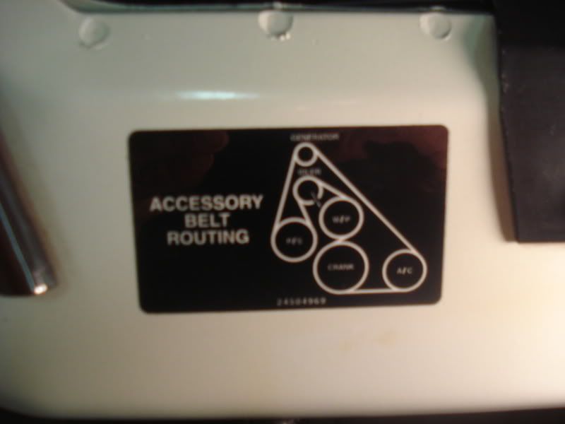

And where would I find such a diagram
Highly recommended to have a belt layout diagram before starting this type job. Not the best pic but you can use this one.
http://i5.photobucket.com/albums/y186/lizzywiz/DSC00127.jpg
SII 3800 VIN "K" Belt Layout. The blurry words are: GENERATOR, IDLER, P/S, W/P, CRANK and A/C
