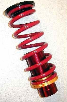

I bought them brand new. Had a friend put them on, he's a mechanic for the Toyota dealership. He put his Function and Form kit on his RSX. He said maybe the spring isn't in place correctly. We're going to have a look at it this Saturday.http://i5.photobucket.com/albums/y157/cool_drummer91/Car%20stuff/4520_fs.jpg

thats what it sounds like maybe spring isnt seating right or top bushing isnt seating right

Oh. Well how would I set the spring right. Because I hit a bump today, and now it doesn't squeak. But any way I can make sure it stays in the place it's at? Like any sealent or anything?

theres usually a groove or notch that hold the end of the spring in place also the compression of the spring keeps it in place too sometimes called a seat for the spring also the upper bushing should have one too

Well when I jack the car up, the springs do move, but I thought they had to in order to raise/lower the ride height.
