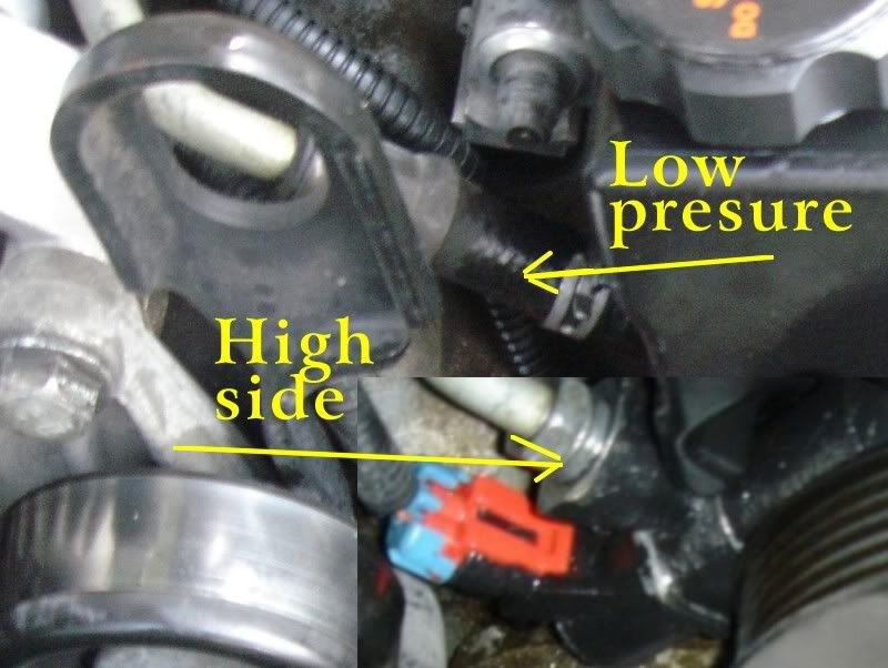

- First remove the pressure line, with a 5/8' line wrench, and remove the compresion clamp on the low pressure line from the pump. You may need to remove the cruise control unit temporarily.
- you can see these lines here.

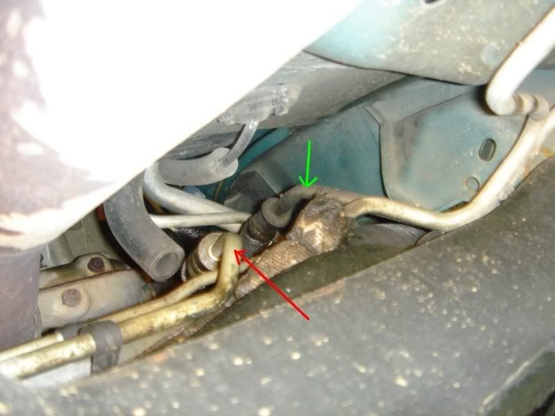

- On the passenger side you will see the hoses.
Red is high pressure, green arrow is low side.
Low side goes through a small cooler shaped like a square, if you cut these lines as a replacement, you should reuse this cooler, two phillips screw holding it to the body.

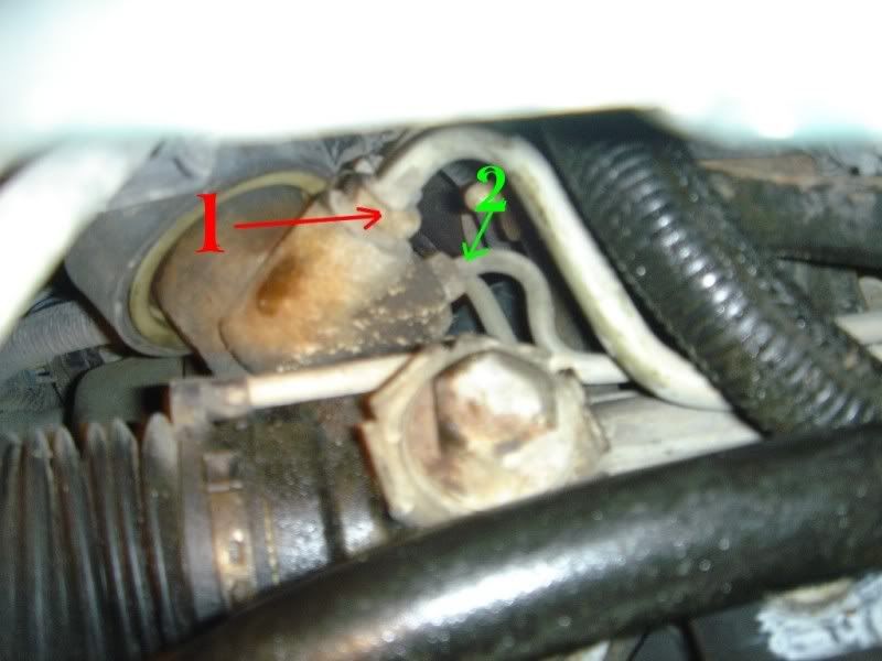

- On the drivers side, is where the lines attach. Again red high pressure , green low pressure.
http://i28.photobucket.com/albums/c242/xeroinfinity/Models/PS_line_Rack.jpg
- These are very tough to get loose! Their isn't much room for long wrenchs, so a shorty(with no leverage) or a crows foot with a short extension and a long ratchet should get them loose.
