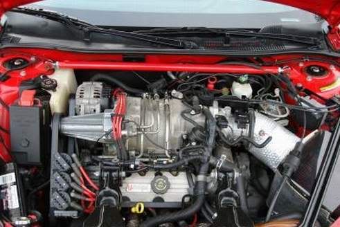

Unless you have the Eaton M90 blower sitting on top of the lower intake manifold then it is not supercharged aka L67. See pic below. Check the 8th digit of your VIN. "1" is supercharged. "K" is normally aspirated SII 3800 L36.
The L36 and L67 engine share many engine parts including emissions related regardless of whether it is supercharged or normally aspirated so you can't go by that.

Thanks, I guess that this is one part that both engines share.
