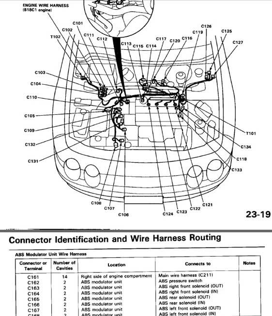

I already have that manual. It doesn't really have that much for engine wiring. I'm looking for something more along the lines of a plug layout, how many connectors are on each plug, and what the plug is for. Like this; from an Integra manual I downloaded:
http://img.photobucket.com/albums/v473/CivicSpoon/ScreenShot00111.jpg
Honestly I'm not positive exactly what I need other than that. The owner sent me a text message yesterday evening and asked if I knew anything about engine harness wiring for his CRX. Then my friend, who I was working with, briefly told me that he was having some problems getting the car to run or run right. So I'm not sure if there are only a couple connectors that don't have a place to plug in, or if wires are switched on certain plugs of the jdm harness. Basically I'm just trying to find as much info and diagrams as possible to cover as much as possible.

the harnesses wont be any different except that the jdm one will have vtec sensors and a place for a secondary o2 sensor. They have the same plugs otherwise.
