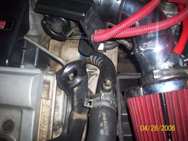

couple more q's while im at it. in the center of this pic, there is a valve of some type on the pipe that leads to the thermostat. what is that used for? it is obviously broken. could that be the cause?
next q, the two cables near the top of the pic, they have quite a bit of play in them, is that normal? if not, what is the part called so i can get them fixed/replaced. the one in front has about 1/2 inch of play before it catches the spindle. the back one has about a full inch.

The valve is an air bleeder for cooling system, no. Does it have cruise?
DnaProRacing
04-29-2008, 01:40 AM
yes it has cruise. works fine.

One cable is cruise, the other is downshift. Sorry for taking so long to get back on this but have had family emergency. Did you press. test cooling system? Has it got the inter-cooler turbo on it ?
Some times older engines just need lower temp to run properly, more wear oil does not develop proper pressure or passages may develop partial plug from build-up of varnish. This can result in rise of engine heat/coolant temp & pressure in system, resulting in intermittent leakage around hard spot in gasket.
