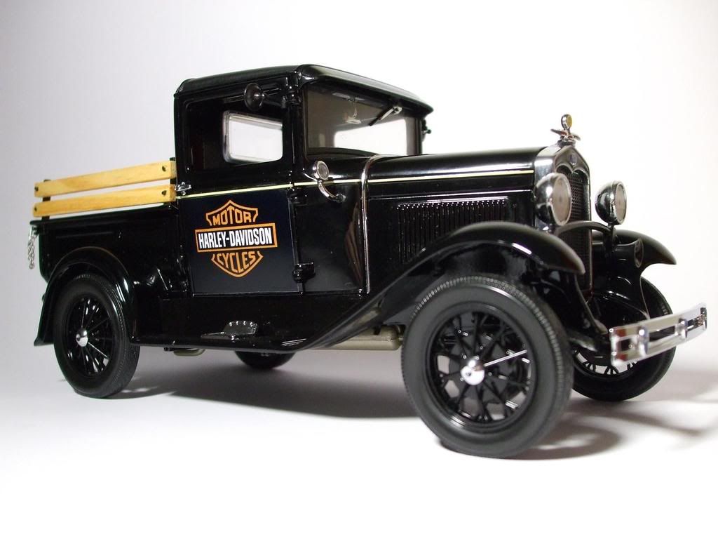

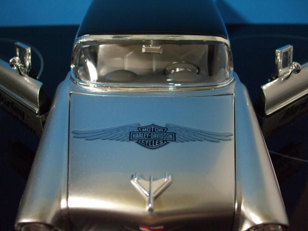

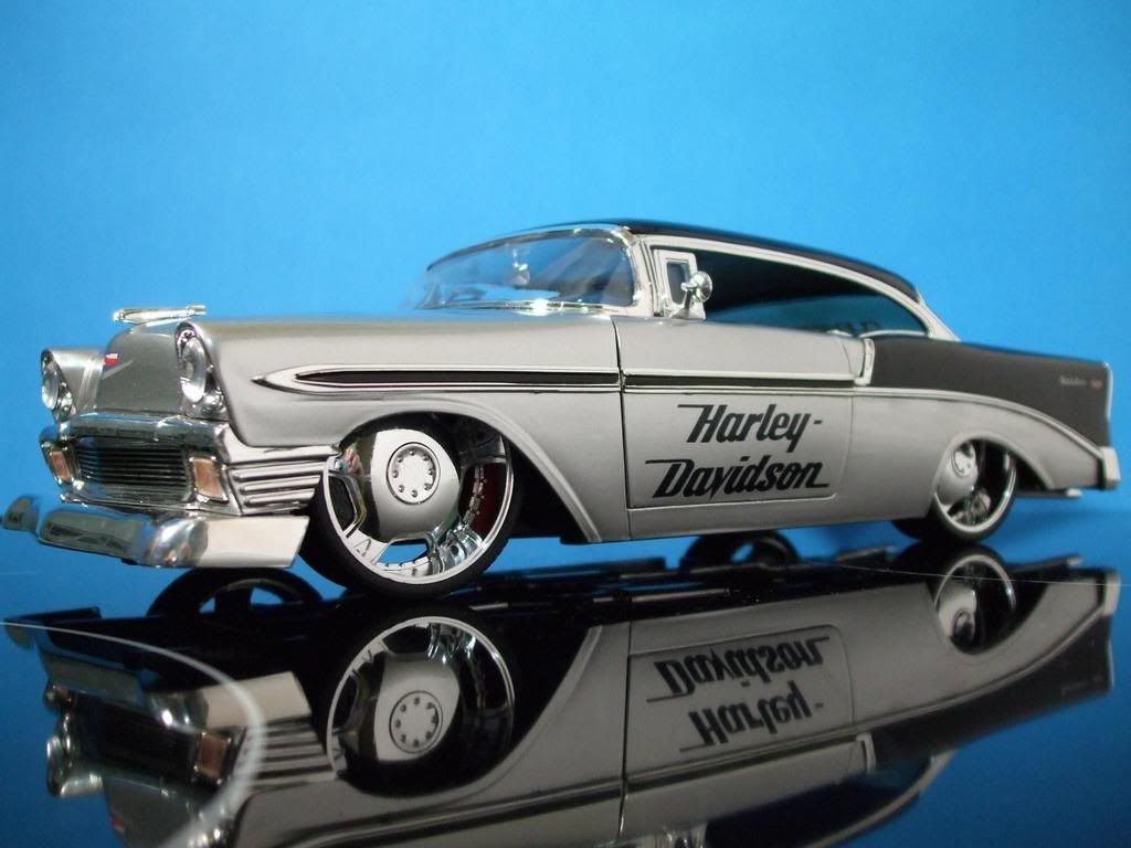

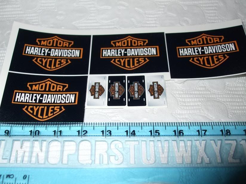

Have a look here at some I have done, nothing special, quite simple, but gives you an idea. They are actually higher resolution printed than my camera can capture, and my camera is 8.3 MP!
http://i260.photobucket.com/albums/ii31/ceejayqld_2007/decals.jpg
http://i260.photobucket.com/albums/ii31/ceejayqld_2007/BA5.jpg
http://i260.photobucket.com/albums/ii31/ceejayqld_2007/BA1.jpg
http://i260.photobucket.com/albums/ii31/ceejayqld_2007/ford4.jpg
The ones on the silver car were plain black printed on clear sheet. The one on the bonnet / hood was trimmed around the actual decal very carefully, but after using some decal setting solution the edge is barely noticable.
The one on teh black pick-up actually covers the entire door below the pinstripe. Is printed on white paper, with black printed background and orange logo. Once the decal was applied and polished you cannot tell between the decal and the paint finish of the car.
By the way, these were printed on a Canon i560 inkjet.
I hope this helps you out...good luck.
