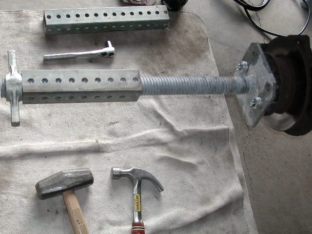

The hubs don't just pull off, you will need a slide hammer of simular type of tool. Firt time I replaced my rotors I made slide hammer type tool.
http://img.photobucket.com/albums/v489/RossT/Image100.jpg
It worked, but I finally broke down and bought a nice one for $80.
If you own a geo metro, sooner or later you will need one.

Yes, you WILL Need a Slide hammer Etc.. to get the hubs off, they dont just slide out. You could make the tool that Ross posted, Or you can go to your local Autozone or Advanced Auto parts and Rent the Slide Hammer for a day, when you take it back, they give you a FULL REFUND (Free). Unless you doing alot of FWD Hubs/Bearing replacements or other jobs requireing the use of a slide hammer, My :2cents: says that renting the slide hammer for a day or 2 is the easiest route to go.
