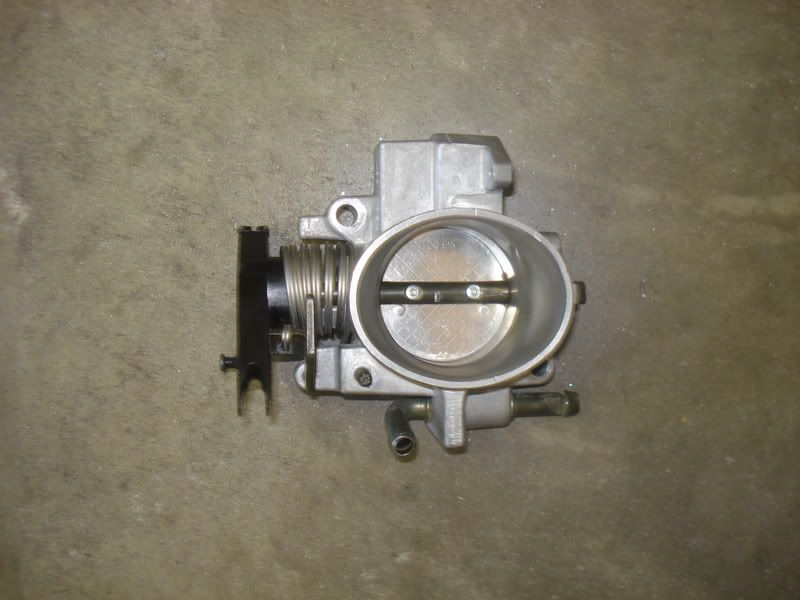

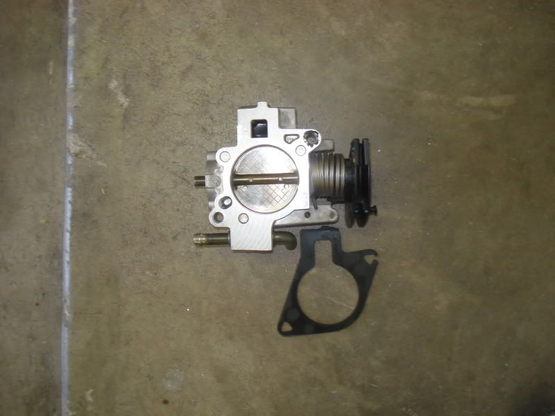

The Seafoam is good stuff as is GM's Top Engine cleaner. It will help clean out the carbon buildup in the upper and lower intake manifold to include cylinder head combustion chambers. Putting it in the gas tank will help clean the fuel injectors. However, it does a poor job cleaning the throttle body especially at the butterfly throttle plate which should be done manually with throttle body spray cleaner. Best to remove the throttle body to clean it up. Also, the IAC (idle air controller) should be serviced separately. The orifice where the IAC mounts at the throttle body should be cleaned out and the IAC spring loaded pintle. Also, separately clean the MAF sensor wire element with MAF spray cleaner.
I should have taken before pics showing the bad carbon buildup but here is a throttle body from an '02 Alero GL2 with 3400 V6 with IAC and TPS removed that was cleaned up manually where you actually have to physically rub all the carbon off. The Seafoam won't help in this respect. :2cents:
http://i5.photobucket.com/albums/y186/lizzywiz/DSC09836.jpg
http://i5.photobucket.com/albums/y186/lizzywiz/DSC09837.jpg

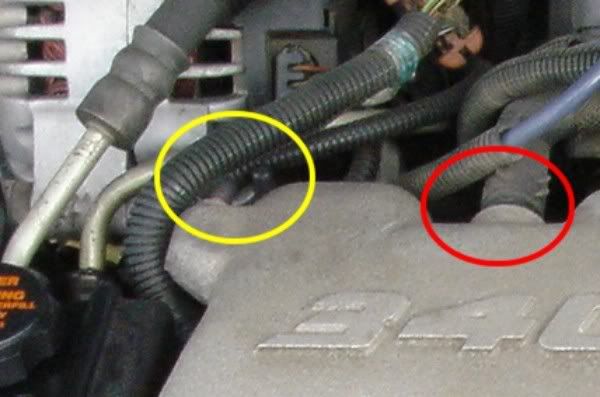

xeroinfinity
04-13-2008, 01:54 PM
I have heard of many people using the brake booster vacum line for cleaning the intake/upper cylinders, I would be carefull !
If any of the seafoam is still in the line and back tracks into the brake booster, it can damage the unit.
Thiers a vac port by the alternator that works great for this too. Yello circle in this pic.
http://i28.photobucket.com/albums/c242/xeroinfinity/11X17RW24/Vacumports.jpg
