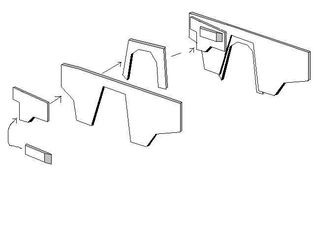

Fire wall is easy, just use the "Stackin' Plastic" method. Cut out the largest area that is the flattest, then stack thin, thick,wide, narrow strips/shapes until you have your desired effect. I've done this with interior panels, engine bays, trunks, chassis, aircraft, etc., It works great.

rsxse40- stackin plastic method?? ok, hrmm, that ssounds diffiult, u mean strips of styrene sheet?? hrmm, thats interesting, il have to think about that, if im understanding what you are saying, you vary the shapes of the strips to give it a cerain shape? like, if the firewall had a bulge in it, you would use a series of strips with a larger section, so that it looked like it

rsxse240
04-12-2008, 12:13 AM
a quick paint program rendering should explain it easily.
http://i108.photobucket.com/albums/n4/rsxse240/model%20stuff/stackinplastic.jpg
Mister_S13_2
04-12-2008, 09:36 AM
oh i get it!!!!! yesn, that might work, ill seei f the LHS has some plastic card,
thanks for that!
