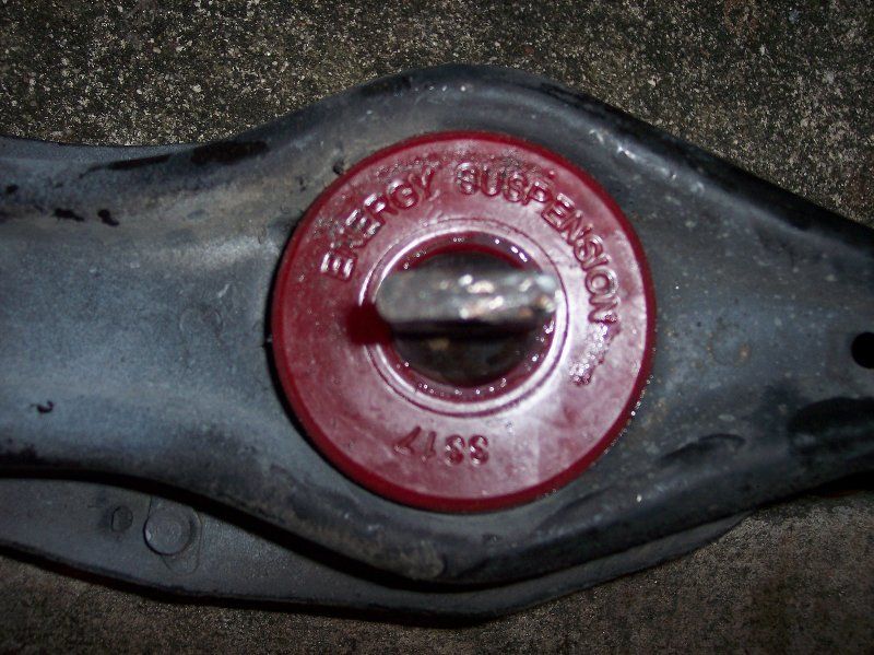

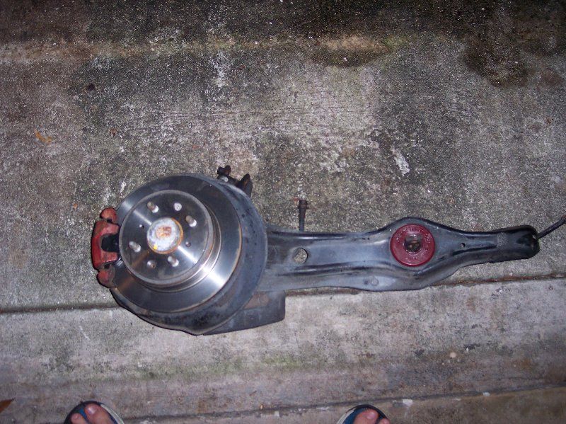

FrodoGT
04-25-2008, 12:58 AM
Well I can, as I have them. They don't squeak one bit. Just use the lube that comes with them. And they are stiffer, but its a very good stiff. They make the ride more confident. They are trailing arms..they just pivot, they don't take a load really so they don't take a shock. If your going to go to all the trouble of taking the arm out to get the original bushings out you may as well do the energy ones. its actually easier because it is possible to do it without a press, I had a press but used a vice instead and it worked great.
my arms.

How much harder is it to reinstall the arms with those? I've installed tons of trailing arms, all with bad bushings and very seldom can I get lucky enough for it to line perfectly up.
There is more force than you think on that bushing...considering you can't find a good OEM bushing in any used arms. So far from what I can tell, that is one of the weakest spots on the rear suspension, seems to be the first to go out.
FrodoGT
04-25-2008, 03:58 AM
Mine lined up with ease. Just make sure you put the pin back in right, it is offset.

FrodoGT
04-25-2008, 02:28 PM
Ive had them for about 3 months now. They havent worn at all, I used the lube they provided (which is like thick icing rather than grease) and they dont make a bit of noise.

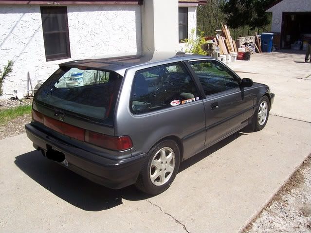

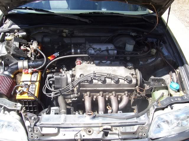

well here are those pictures finally, the car was hit in the back before i got it and has the usual honda rust but it is only just starting , hopefully that will be taken care of this summer. also need to get a battery hold down or move it to the back.
