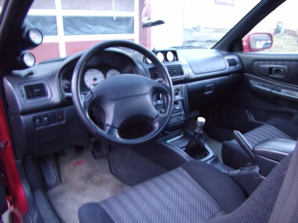

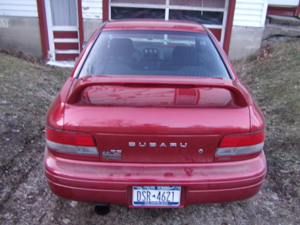

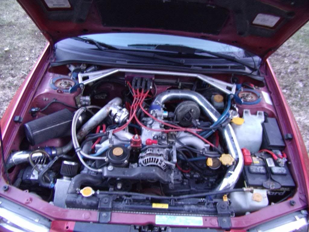

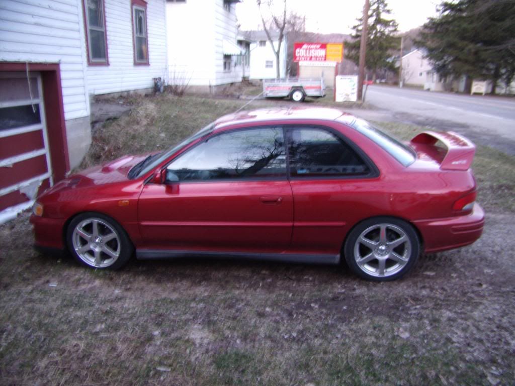

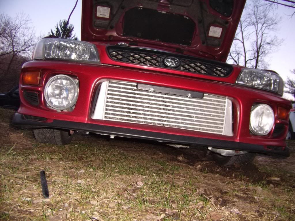

So finally did it. Got tired of Fwd and went awd. Bought myself a 2000 Subaru 2.5RS w/sti conversion.
-Electromotive Tec 3 programable engine computer
-magnacore wires
-walbaro 255lph fuel pump
-custom high flow fuel rails w/ AN fittings, SX adjustable fuel pressue regulator,mechanical fuel pressue gauge
-Racetronics low imp.siemons 780cc injectors
-ARP head studs
-2.5 sti turbo short block
-STi oil pan/pick-up,oil pump
-Act clutch w/ street disc
-Forester watercooled oil cooler
-vishnu big turbo kit (to4e 60ar/.64hot) tial 30mm wastegate tial 50mm blow off, 2.5"ss up-pipe,3"ss down w/ race clamp connections,catch can
-hybrid front mount intercooler and piping
-Rallispec mandrell 3'' stainless cat back w/ magnaflow,interchangable high flow cat and test pipe,all connections using ss race clamps
-borla ver.4 ss headers(headers,up/downpipe DEI wrapped and silicone painted black)
-ver.6 chin spoiler
-sti rear tail lights
-17" 5zigen fire balls/conti.extreme contacts
-Jic-flt-a2 adjustable coil overs(height,dampening)
-whiteline anti-lift kit,20-24 adjustable rear sway bar and heavy duty mounts
-strut top bars f/r
-5 autometer gauges boost/vacum,egt,electrical fuel pressure, oil pressure,water temp.
I am starting from a mildly modifed car this time. No longer starting a major project from stock up. It's a Nevada car...no rust :P
Just need a tune, new spoiler and a black paint job.

You said it has "2.5L STI shortblock", but not what the heads are?
What's emissions testing like in NY? How did you make it pass? Is the OBDII port "legit?"
mtcs
04-09-2008, 09:58 AM
Not too shabby! ;)
The heads are RS heads for now....I have STI heads but they need a little work before they can go on the car. RS heads are fine for now.
For emissions...I need to change my standalone back to stocker....then she'll pass no probelme. Yep...OBDII
FuJi K
04-09-2008, 11:00 AM
I was expecting to see some STi engine in there. IF you want to run the STOCK STi ECU, you'd need to have the harness etc. So I take it you're running the TEC 3 on the 2.5RS harness??
