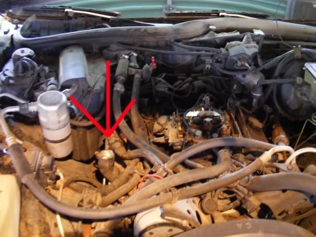

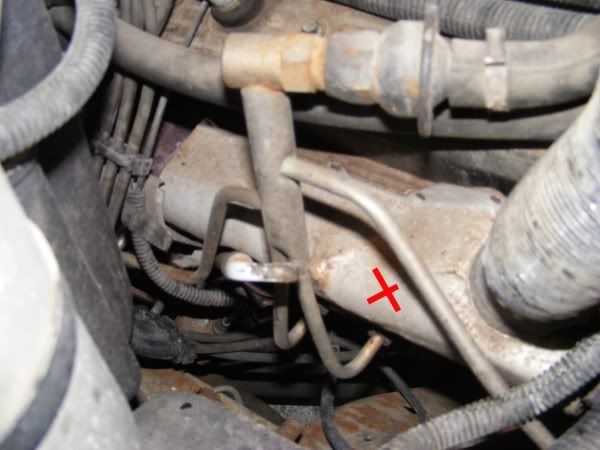

Among other strange things, my car isn't running like it used too :( So I'm tinkering around with it seeing if some parts need replaced or cleaned, and when I took the intake off, I noticed that the little sliver thing ( I believe it to be a heat shield of some sort ) was loose! What is this part? and whats its purpose? Also, for those of you with the same 305 small block V8, does your engine have that little flimsy metal coming from the bottom of your intake, to part X?

That is the heat stove, which in turn is a part of the early fuel evaporation system. Not only an emission control device, it also helps your engine run smoother when it's cold. The metal hose connects the heat stove to the air cleaner. There is a flap in the air cleaner that directs warm air from the heat stove into the air cleaner when the engine is cold.
Urstin
04-04-2008, 09:33 PM
Ahhhhh! It all makes sense now. But should the "heat stove" be loose?
silicon212
04-04-2008, 09:35 PM
They get that way from time to time. You can use a small hammer to drive the rivets back into the exhaust manifold if it's vibrating.
Urstin
04-04-2008, 09:38 PM
Okay cool. On last question, the little metal hose, its cracked near the stove itself, what would you suggest I replace it with?
silicon212
04-04-2008, 09:41 PM
They sell replacement hoses that you can buy at any parts store. They work well, although you might have to trim to fit. Scissors work well for this.
Urstin
04-04-2008, 09:43 PM
Cool man. Thanks for all your help! I checked out the link in your sig, YOUR ENGINE IS SO CLEAN! hahaha, I so hate Michigan!
