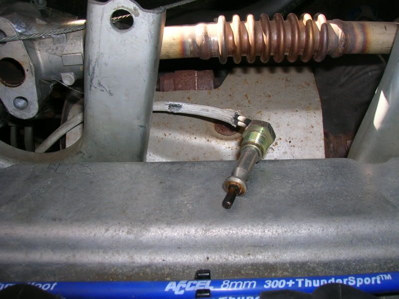

I noticed this morning that the wires on this sensor has been cut - probably due to the wires rubbing on the metal frame during installation. I think it's called the exhaust high temperature sensor on WINCAPS (part # MD305556) but I'm not sure. Anyways, anyone have an extra one? Jason???? :rolleyes:
http://i50.photobucket.com/albums/f350/sLADe781/DSCN5130.jpg
-Oh yeah, I have a '94 SL with EGR. Thanks.

You can block off your EGR and use a 10k ohm resistor in place of that sensor. No real need to buy another one. I'll dig around to see if I have a spare though.

Not 10k ohm. 10 ohm. 10k ohm is a HUGE resistor.
If you want a resistor I'll mail you one. All you have to do is bend the resistor into a U and "plug it in" to the spot where the EGR plugs in. The just run some black tape around to hold it in. No CEL and no more EGR. :)
You just need block offs to complete the mod.

Brian, it is a 10k resistor. I posted under emilie's name out of laziness yesterday haha. It's not a huge resistor. It's as small as a 10 ohm resistor :p

The 10k resistor I had was huge.
I'm now running a 1/2 watt 10ohm resistor and it keeps the CEL away.
