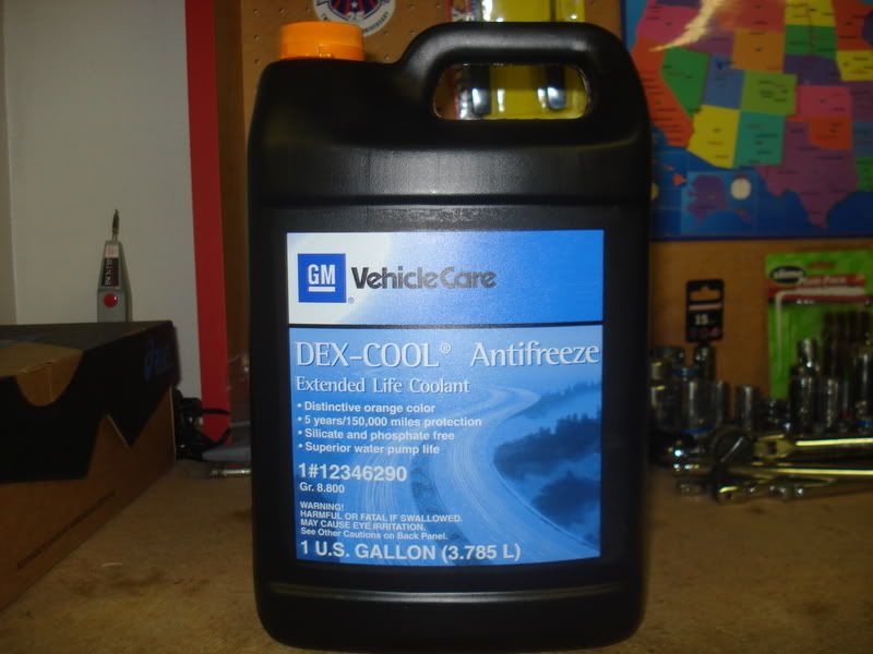

I switched a few years back in my GTP because it was less expensive and easier to come by. Plus I replace coolant at tighter intervals like around 36K miles and always do a thorough flush. Not because I had any problems like sludge. However, I still run GM's Dex-cool in all my other GM cars.
Prestone claims the 5/150 extended life green does not damage any aluminum engine components or radiators but helps protect and from what I understand it is still OAT (Organic Acid Technology) based like Dex-cool. Now as far as GM's Dex-cool technically it is an ethylene glycol based product just without silicates and phosphates. It says so right on the front and back labels.
http://i5.photobucket.com/albums/y186/lizzywiz/DSC08894.jpg
