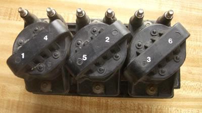

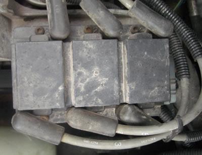

shilohin
04-03-2008, 04:16 PM
No, I have not replaced the coil. It still has the original coil that came installed with the car. Here's a photo of the coil that is in the car now:
http://i284.photobucket.com/albums/ll8/shilohin/coil/coil.jpg
<p>
This is a coil that I have that a friend gave to me a few years ago. It was pulled from a working 1990 Buick Century with a 3.1 engine:
http://i284.photobucket.com/albums/ll8/shilohin/coil/coilspare.jpg
They both use the same connector but someone told me you HAVE to replace the coil with exactly the same model, which is why I haven't swapped it out with the spare I have. Any ideas?
Also, I have Champion plugs. I installed a new set about 3-4 months ago. The car had some brand of platinum plugs installed when I bought it and they would miss after about 4,000 miles. I got rid of them and installed copper Champion plugs. My first car was a 1968 Buick Riviera GS that had Champion plugs in it when I bought it. Later I replaced them with AC plugs thinking they would be better since they were what GM recommended. The AC plugs would start missing after about 3-4,000 miles so I put Champions back in it and never had anymore trouble. I've been sold on Champion plugs ever since. BTW, when I recently replaced the Champion spark plugs in my Bonneville with new Champion plugs, the old ones had probably 35,000 miles or more on them and you could hardly tell them from new ones. No fouling, not burned, looked excellent. I replaced 'em anyway. Thanks for your help!
<p>
Jrs3800
04-03-2008, 04:36 PM
Ok here is the deal..
The only V6 offered in the 1990 Buick Century was the 3300 Buick V6, Little brother to the 3800...
The coils you have would work, but the ICM( Ignition Control Module ) will not work with your Bonneville... The Bonneville is a SFI( Sequentially Fuel Injection ) car...
The 3300 V6 was a batch fire MFI system, iirc this system fires 2 injectors at the same time.. The Module from the buick will also be keyed differently..
You would have to have a 3800 V6 ICM to be able to use that system.. The Delco system does fire a bit hotter than the original Magnavox system.. I have ran everything from AC Delco Plugs to NGK TR55 Plugs with good results on the Delco System...
Bosh Plats are a no no with the 3800's..
If you have any questions at all i will be more than glad to help you with them:)
I also neglected to ask.... Are these the wires on the car now?
If these are the wires on the car, they are all original and most likely should be replaced..
I still your problem in ignition related... Possible coil or wire( if original )
