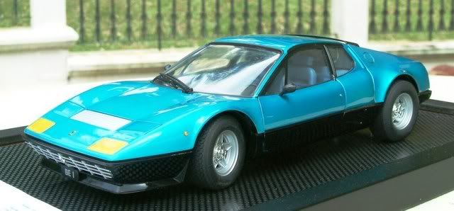

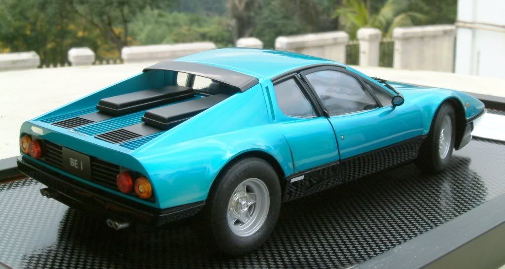

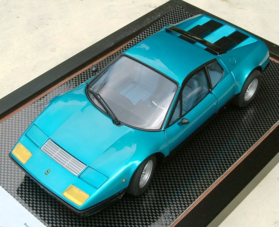

Hi! I am not sure if I can help but I had built a Ferrari 512BB. It looks almost the same colour you are trying to fix. Basically I used Gunze super silver as a base and added clear blue till I get the right depth of blue. Well it is a lot of work as you need to test and record your mix. Take a look at the ferrari.
