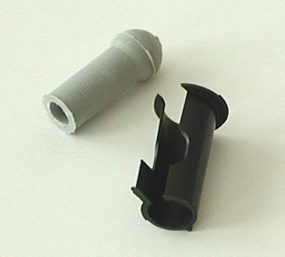

Also if you find a good parts person at a gm dealer their are a few cars (i forget which ones) that take a replaceable plastic bushing that goes on the shaft of the visor. This will restore the tension and make it like new.
I do belive there are only two different bushings though, a small one and a larger one. We use to keep them in stock and sometimes they would fit cars they were not meant to fit. The bushing's were a dollar or two.
Here is what they look like but i do not recall the part number it has been over 4 years since I worked at a dealership.
John
http://i27.photobucket.com/albums/c168/jgillham/bushings_03.jpg
