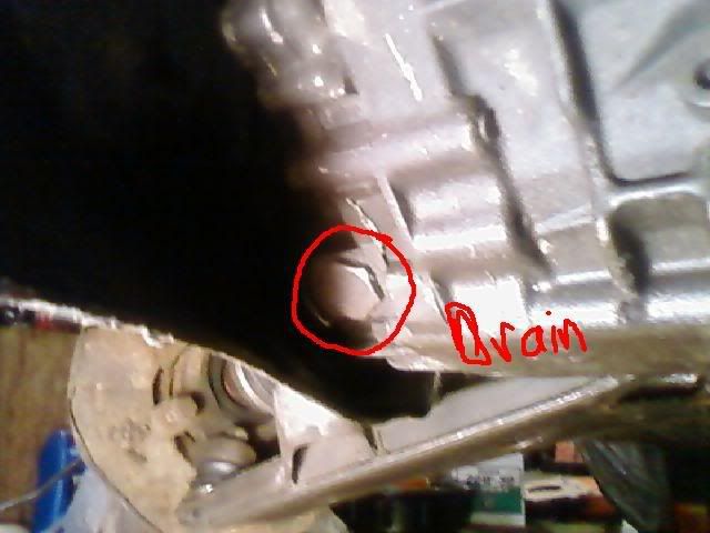

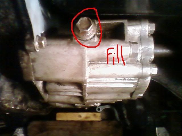

That is for a manual. The fill on the t-case is right at the front just below the oil pan. The drain is on bottom pointing directly at the ground. You will see it. Both fill and drain on the tranny are on the far left side. Want pics from a 1G?

T-case fill:
http://i11.photobucket.com/albums/a191/tfoti/0322082214.jpg
Tranny drain:
http://i11.photobucket.com/albums/a191/tfoti/0322082215a.jpg

T-case fill:
Tranny drain:

awesome pics man! Those are very good pictures for a camera phone. I can't wait for the damn snow to melt ahhhhh It just snowed another 3 or 4 inches this morning!!!!
