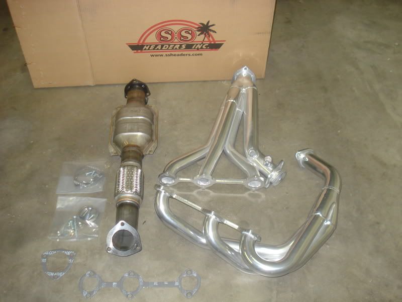

I just completed installation of these S&S ceramic coated headers on my son's '02 Olds Alero GL2 (3400) and it took way longer than 3 hours. :grinyes: Same for my SLP headers on my GTP. Although it costs more stick with the ceramic coated because you will not need any heat shields or heat wrap and the headers run hotter which supposedly transfers exhaust gases better improving the scavenging effect and increased power gains over non ceramic coated. :2cents:
One advantage S&S headers have is there is only one flange with donut to connect and not a totally separate crossover pipe. Disadvantage is the pre CAT 02 sensor bung is mounted on the pipe from the front bank and not the collector so the 02 sensor reading or sample is taken from those cylinders only. A post CAT 02 simulator may have to be used or PCM re-programmed to inhibit the P0420 DTC you may get intermittently.

Unless it has changed since the old S&S data goes back to 2006 welding is required as was the case with my SLP headers. Technically the input of the CAT should be welded and not clamped or flanged with bolts. However, check with S&S pre-sales or tech support at the web site given earlier or you can call them by telephone just to be sure. Now for the 3400 GM 60 degree engines the S&S header install was a complete bolt-on operation with no welding required. We got the package with the 2.5" Magnaflow hi-flo CAT, 2.5" downpipe/woven flex joint section as you can see in the pic. It bolted right up to the resonator flange and the collector output. But it was up there in cost at around $867 plus shipping from Phoenix, AZ.
