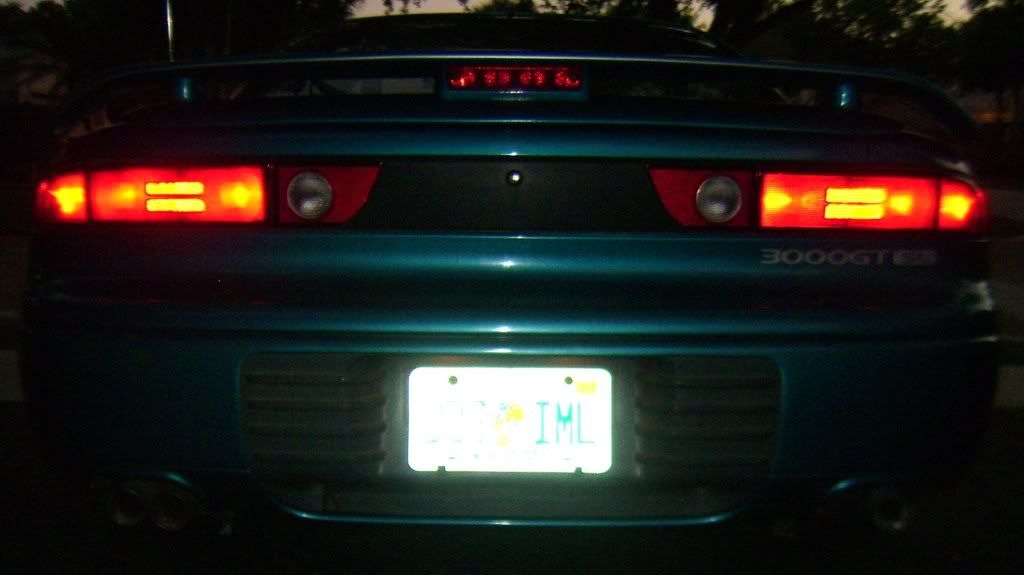

http://i248.photobucket.com/albums/gg195/ozzvette/fromtherear.jpg

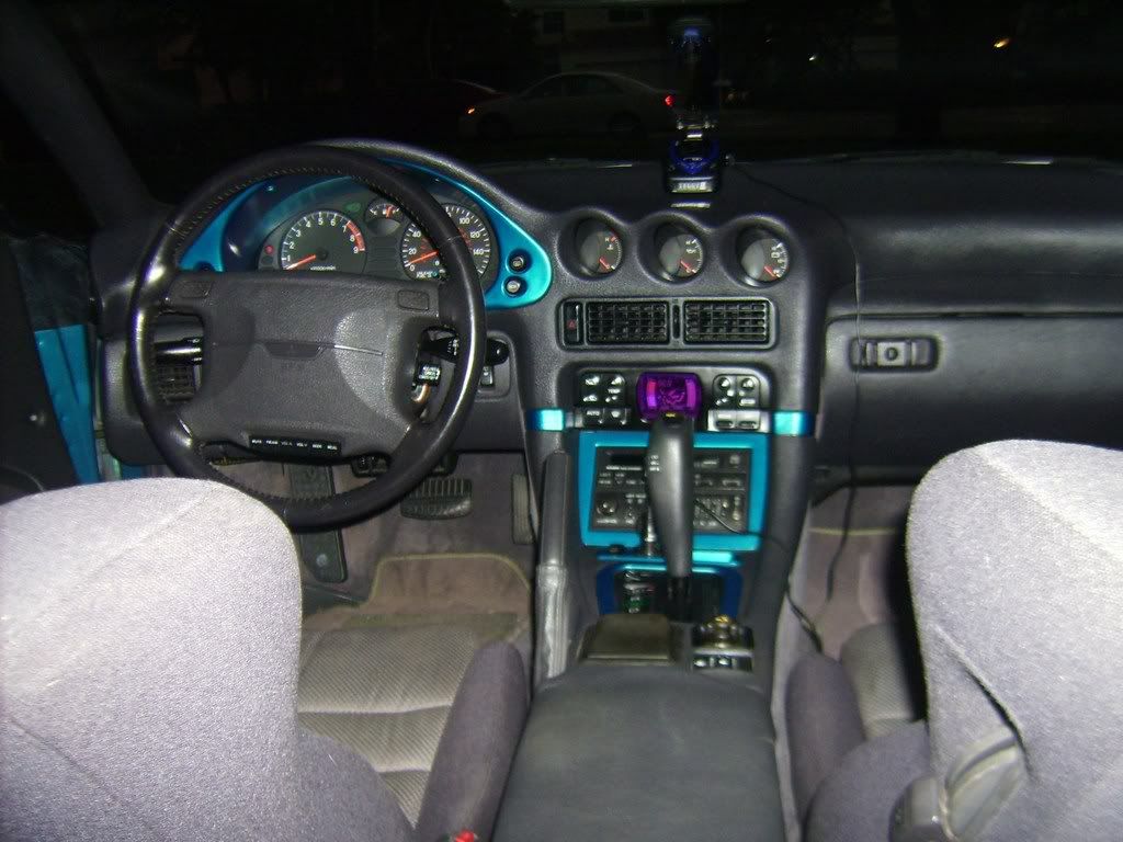

http://i248.photobucket.com/albums/gg195/ozzvette/interior.jpg
http://i248.photobucket.com/albums/gg195/ozzvette/DSCI0113.jpg
im still figuring out how to use all these forums lol, but heres some more pics of my car...notice the later tail lights that had me confused when i bought the car :) lol
glad to hear you're gonna fix her up. Definitely keep us updated.
oh yea, post more pics too in the pics thread!

strange...the previous owner went through the trouble to match the rare color and paint some interior trim, but didnt paint the center garnish on the tail lights.
looks good though man. hopefully your downtime will be a minimum and you'll be back behind the wheel this summer.
I also notice that the car has an Active Aero rear spoiler...i didnt think that was an option on the SL??? Does it have the front to match? is it functional?
it was ONLY available on the VR-4. The car may have been in an accident, and that was the spoiler they replaced it with, not knowing any better. Or, the previous owner just really liked the active aero spoiler. I know of a few people who have done that.
BTW, I have those same seats in my SL in my sig. I LOVE them!! Probably the nicest seats these cars came with from the factory!! :cool:
the car has never been in an accident, i think the previous owner just liked the spoiler (seeing how as he changed the brake lights as well). i thought since the whole rear end was changed like this that yea there was a previous accident but the guy i bought it from said there was never a wreck, nor is there any evidence of bodywork anywhere...everything looks untouched.
there is no active aero switch in the center console, and im not able to drive it right now so ill have to get back to you if it's functional or not. there is NOT a spoiler in the front tho :(
but yeah the seats are really nice to be in :)
